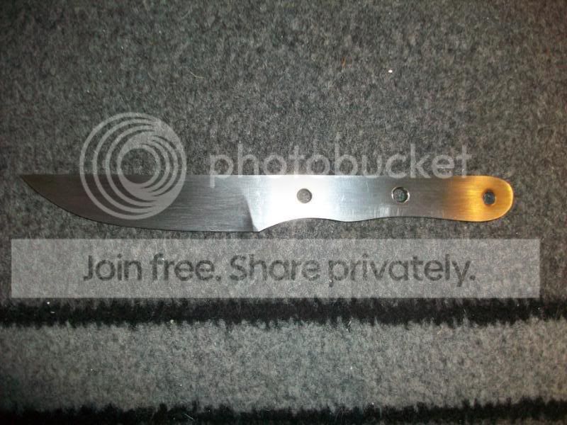

Well since I got one of the steak knives drilled I figured I may as well try and get a bevel on it.

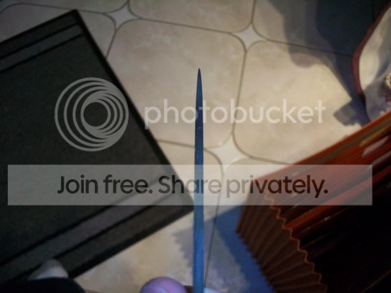

I decided I would have a go at using the 4x36 to grind the bevel... used a 120 grit belt.
I went very slowly at first, and was very scared to screw it up... eventually I got a feel for it and it turned out surprisingly well!
The sides aren't 100% equal, so I may take it back to the grinder and grind a little more into the plunge on the one side (the side I haven't shown you lol)...
I finished the knife to 220 grit, and it will go to 400 along with the other 3 when they are drilled, countersunk and beveled.
Tip was nice and even too so that was a nice surprise.
