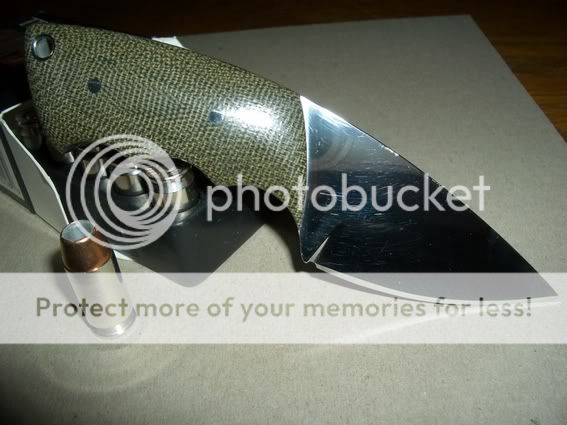

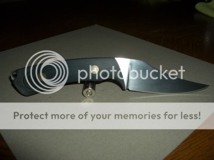

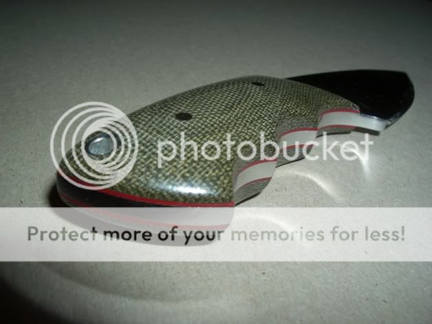

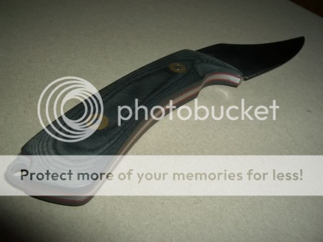

New to forums and Posting as well ,sorry for the Bad pictures. I've been lurking around here for a few months reading,reading and more reading. Finally finished up my first two knives.
First one: 1/8" 1095 8-1/2" overall 3-1/2" blade, black linen micarta red spacers. Scotchbrite finish. Full quench, tempered @ 400 for 2 1hour cycles.
Second is 5/32 1095 5-3/4" overall 2-1/2" blade green canvas. red spacers,polished (sort of).Nickle silver pins and thong tube. MApp gas heat treat. Tempered @ 400 for 2 1 hour cycles w/ soft back draw. (Thanks to Kim Breed and Gary Wheeler DVD) Great heat treat DVD!!!
Thanks for Looking , please be brutally honest.

I really like the second one. The first looks a little awkward to me, but then again, I've never tried it. Great job, keep up the good work!
To be brutaly honest, I don't how I would feel about the designs till I had them in my hand, I would prefere a little more rounding of the first one for example. Workmanship looks to be excellent, and light years beyond my first, or 21st! You sure those are your first?:thumbup:
Your knives are way better than my first and even some of my recent.
However the top one just does not quite grab me as much as it should.
The workman ship is great. Design is always personal taste and bassed on what you are going to use it for.
If you want to send me an email with blade forum knife as the title I will photo shop a couple of minor changes to your blade just to show you how a couple of mm or an axis angle change can effect the look.
Remember I will not be right and you will not be wrong just a couple of variation to compare.
They are fine knives. I was only thinking of the top knife. I have it already downloaded but will not work on it uless I hear from you if I don't here in a week I will delete it.
Keep up the good work. You have a big future.

You sure have some fine knives there, to be proud of for sure! One thing I would like to point out is,the bottom front of your handles. I've learned from experance not to bring any handle material to a narrow sharp point as this creates a weak area prone to breaking off. A small radias on these areas would prevent that from happining and not take anything away from the looks of the knife..........keep up the fine work
yeah buddy!!! Looks great to me. VEry well done.
Those handles are looking fantastic. Great for first knives man. I have two things that I can see that kinda dont sit well with me. This is just my personal tastes, and it is in no way degrading your knives.
1. The blade shape on the first knife looks awkward to me. The handle is phenomenal, but the blade seems off to me in some way.
2. The second knife is great, but from what I can see of the picture, the grind line seems a bit short.
They're great knives man. You asked for brutal honesty, and the only brutal honesty I can give you is positive. My critiques are just based on my tastes.
I messed around with your pics and came up with some ideas. Hope you dont mind.
Shawn I have sent the pics if you have any trouble openeing them let me know and I will recend in a different format. Now knowing your intended use for them it is easier to picture the axis angles.
If you are making knives for a particular job you are doing yourself, you will know what feels right and works best so anything I say is just an opinion based on the lines and look of the knife not how well it will perform. Ultimatly a knife made and modified by a user of knives for a sepcific job is more likely to do the job well. My brother is a slaughterman and he has a set of knives all for particular parts of the beast. He goes hard all day and knows what he likes and what makes his hands puff up working too hard.
