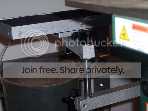

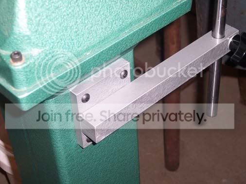

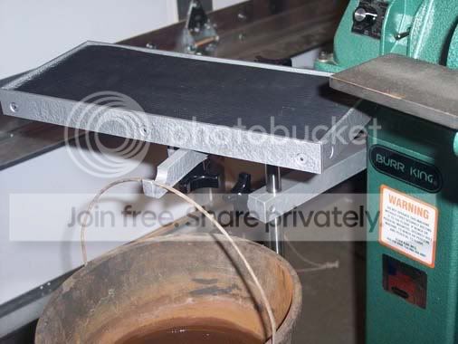

Very cool project Will.I agree will you about the BK but I have a seperate small wheel grinder.Here's a little table setup I made for my BK since it is pedastal mounted.It's fully articulating and also holds my water bucket.Dave:)
