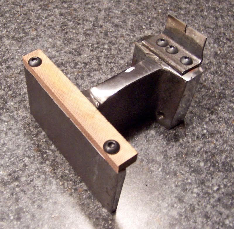

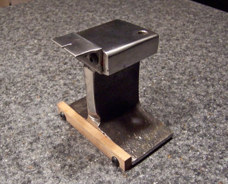

If you repair knives you probably have, or want, a stiddy to work on the knives.
The problem is that a stiddy is expensive, (my first one cost me $250 + $30 shipping), heavy, & expensive to ship.
I think I have solved that problem with my compact stiddy. Made from railroad track it weights about 7 lbs. I made one for a friend and was able to ship it in a Priority Mail flat rate box for about $11.
http://
I have included a strip of canvas micarta so I have a softer surface that does not mar the bolsters. I lay the stiddy on it's back and have a soft surfact face up.
http://
It makes it much easier to repair an Old Timer.
What do you think?
Comments welcome.
Dale

Dale, please tell more of what you use this "Stiddy" for and how you use it if you don't mind?
Thanks Shawn
Hummm....Maybe I should do a tutorial.
But briefly.......
The name "stiddy" I am told, comes from the Welsh pronunciation of the word "steady." Apparently many Welshmen worked in the old Sheffield cutleries.
The stiddy is the cutler's anvil.
When repairing a knife I use the hole in the top to drive a pin out of the knife (usually a bolster pin) with a pin punch.
The micarta is a soft place to pound (usually more like tapping) on a knife without marring the bolsters.
The thin lip (peening horn) is used to flatten out (peen) the inside end of a pin that holds on the scales (handles). It is used so a cutler can pin the scales on the knife without taking the knife completely apart.
The top of the stiddy is used like an anvil when peening pins, especially the pivot pins. This is the one time where you really hit a knife hard....if it is an LB-7 you really need to smack it to peen the pivot pin, (there is technique involved, not just brute force).
The elevated top of the peening horn is used to bend blades to crink them.
Look down on the closed blades of a 3 blade,2 backspring knife. Note that the blades are bent so that they fit in the knife? That is crinking.
Crinking is done by hitting the blade while it is resting between that raised edge & the top of the stiddy. Needless to say, crinking is a bit tricky. :eek:
Hope this helps.
Let me know if you have more questions.
Dale
