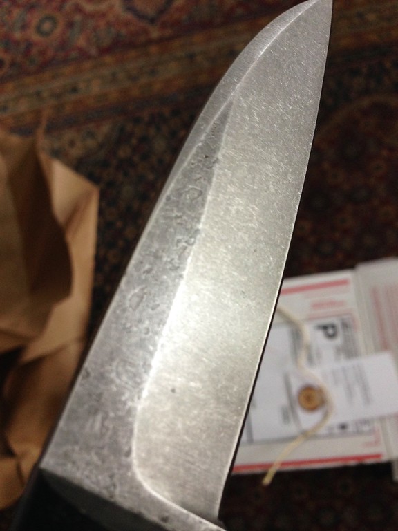

Here's a close up of the new finish on the Bushraptor I got today.
Nice finish. Reminds me of a CRK finish. Maybe I'll try to get some comparison shots.
EDIT: Pulled out the CRK and the finish is nothing like that. It's really close to the Hinderer. Upon reflection the blade shape is closer to a CRK Insignio.
OK I did a test. I cut a tomato with a tumbled A2 Bushnub. Then I waited two minutes before rinsing. I left it wet with tomato juice for two minutes then rinsed. No patina. So I went to an apple. Cut it up and let the juice sit on the knife for 4 minutes. Rinse. Still no patina. I am going to try 01 next.
Nice pic. That really shows the finish perfectly. That Monarch was very tempting for me. I couldn't put it down.
