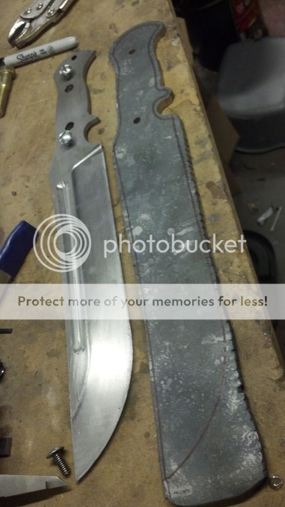

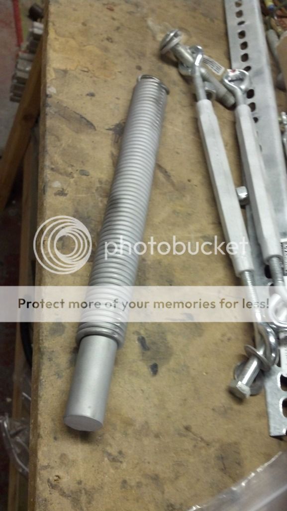

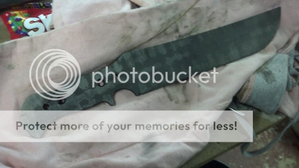

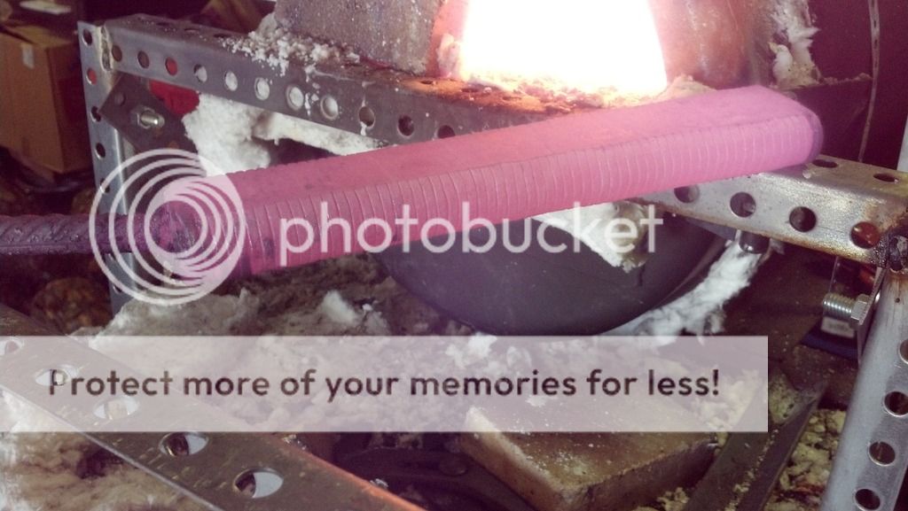

Has anyone ever wrapped a core of tool steel with an actual spring?
Some snippets of something I have been working on:
Still working on it, but I am curious if anyone has ever done it before. The key is to reduce the amount of surface grinding so you can see the pattern more.

True, but that is also an actual spring.. so I get to use the term spring steel with impunity ;)
I am just curious if this is something someone has already done. Hard to break new ground considering men have been hammering steel for millennia

I have seen heaver springs annealed, flattened on a bar of 1095, and forged into a faux-twist damascus. It was OK looking, but nothing to get excited over.
30 years ago, I have seen a billet made that way yielding a basic ladder pattern in the end. Nothing new under the sun...

No, it was just parallel lines like a tight twist pattern. Stubb I have seen had a variance of pattern.
I did a demo a few years back of a four layer billet with 4 alternating layers of 1075 and O-1 Each was 1/4" by 1". Once welded up and squared, the surfaces were ground clean. It was then forged round, cleaned up again, and twisted as tight as possible. When forged flat it had a bold twist look that made me think of Vikings ... so I made a dagger from it.

This thread has me thinking about how you might make a faux twist barrel by using say a big garage/overhead door spring with a core of some other steel.
