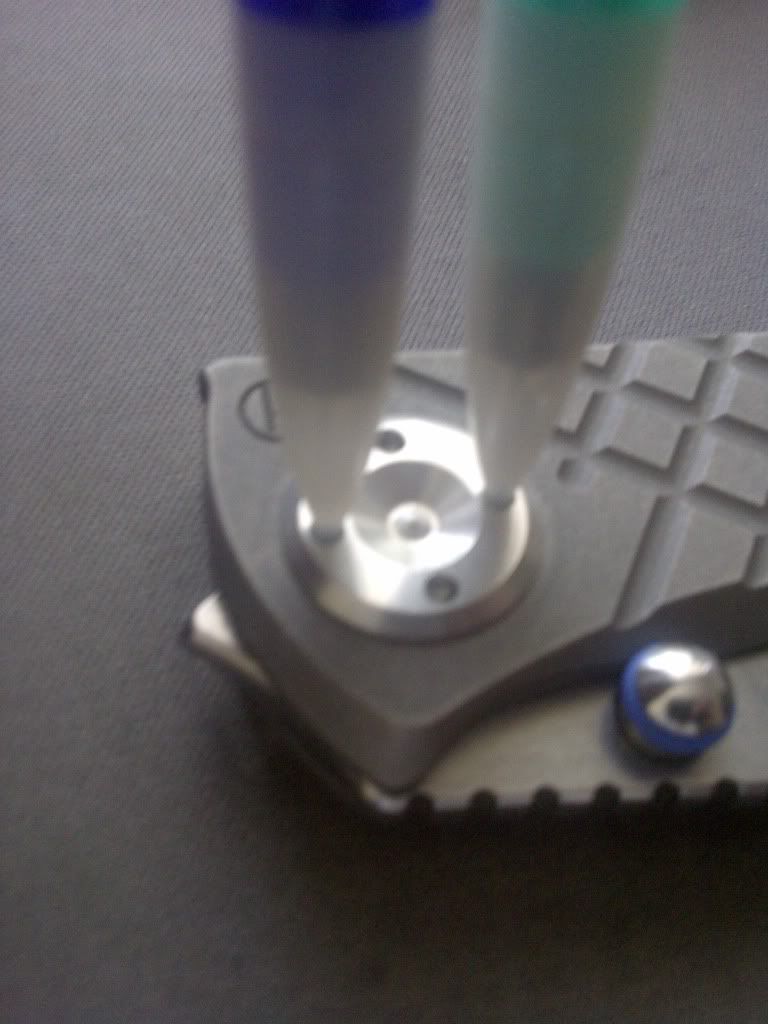

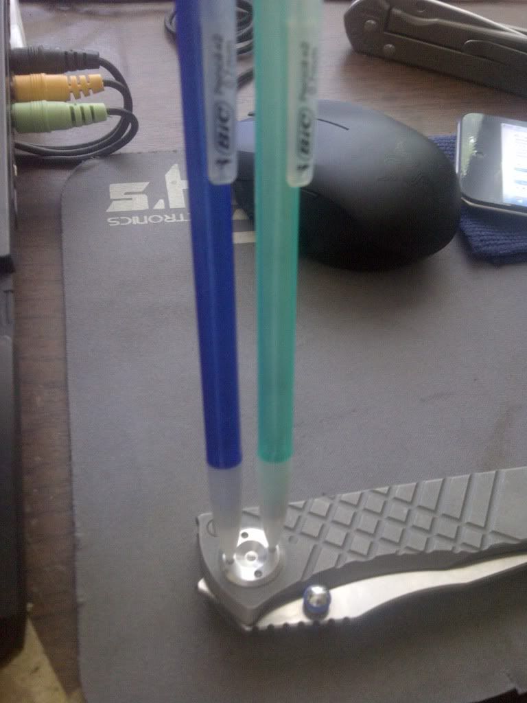

Here is a cheaper solution to opening the Umnumzaan without buying the toolkit or snap-ring pliers:
Costs about $3 for like 10 of them
Wow! Ingenious!!!
Do you need to hold down the pivot screw on the bottom so it will not turn?
Also, which Bic pens are these? Hard to tell from the photos...

For my umnumzaan I dont really need to hold down the other side the friction from pin contacting the handle is enough to hold it in place while I unscrew it, but if you have to just use two on each side. They are the Bic pencil#2 0.7mm lead.
