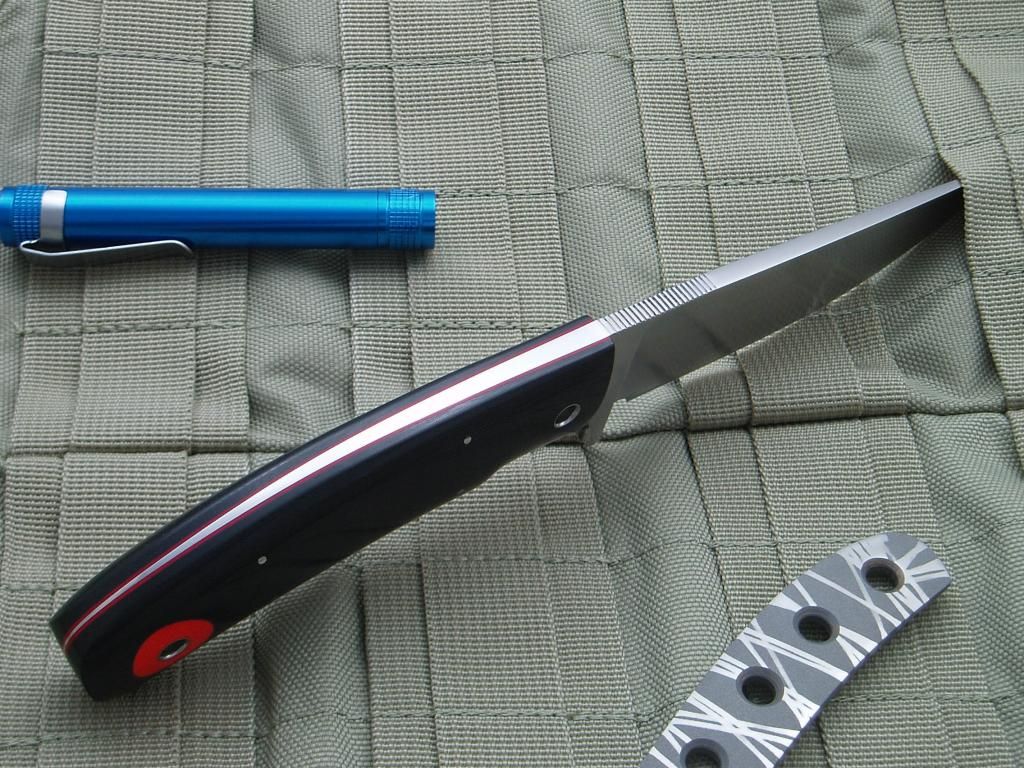

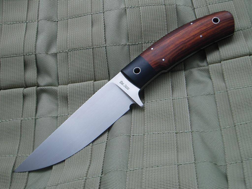

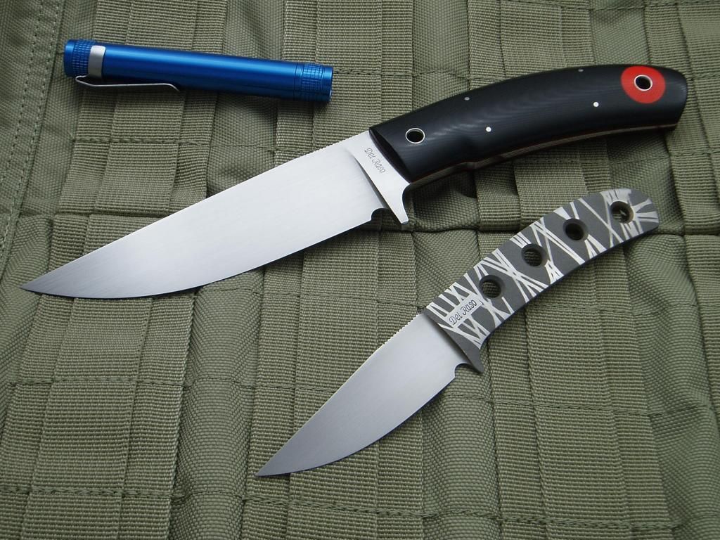

Two versions of a new pattern for an up coming show. Both are 3/16" ATS34 with full flat grinds and full tapered tangs. OAL 9 3/4" X 4 1/2" cutting edge.
First one has black linen micarta scales with high vis hunter orange G10 inlays, and red fibre liners. Pins and flared tube rivets are stainless.
Second one has black linen micarta scales with a step milled out for the ironwood overlays. Pins and tubes also stainless.
Hope you like them, comments welcome.
