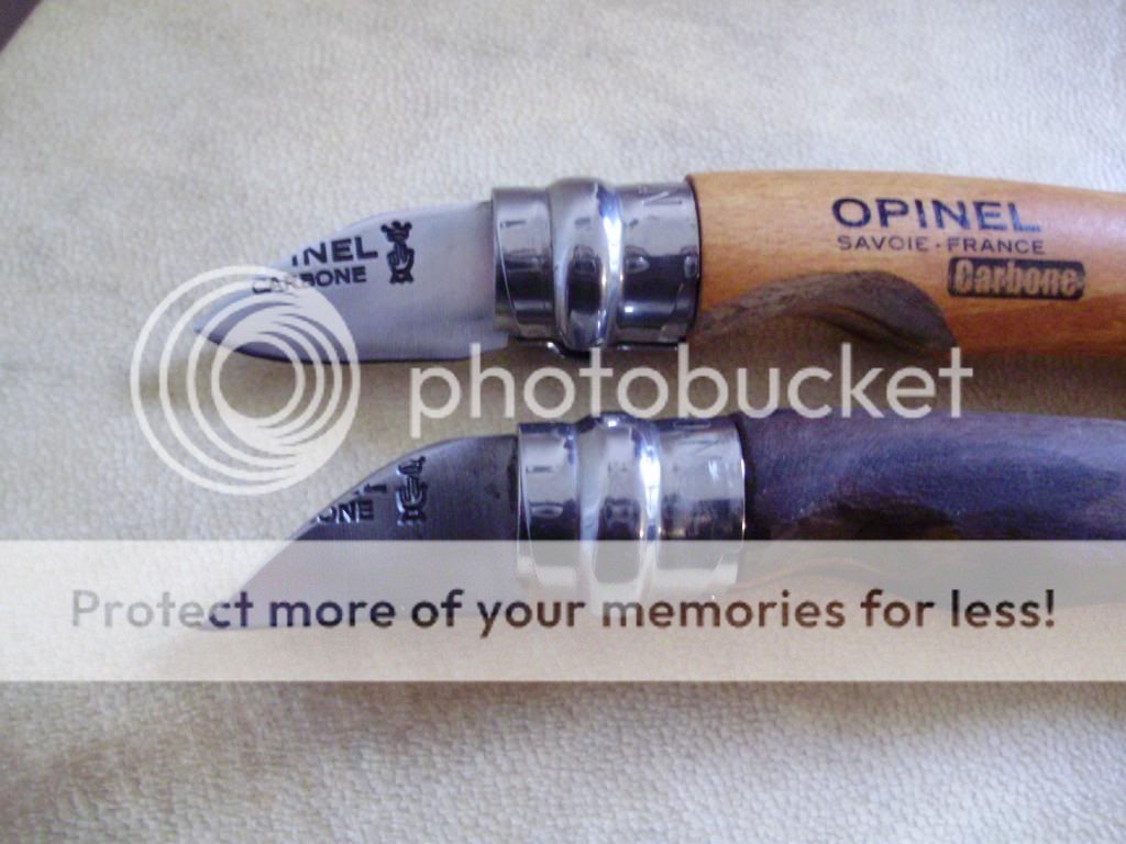

Here's a set I made from a couple of Opinels:

An Opinel or two with a modified blade (s) is a great choice too.
I cannot tell the difference between stainless and carbon on any level of performance with Opinels.
I use this one a lot:
