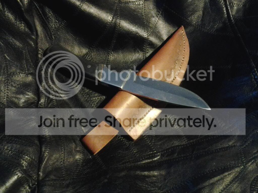

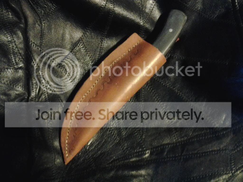

I guess it's time for an update.
I coated the handle with a spray-on clear top coat. Then decided I should have sanded more. So, off it came. Now I'm going to leave it as is, with no coating/sealing.
I made my first sheath also. Tried a little stamping.
I'll get some pics soon so everyone can have a chuckle. Then when you quit shaking from laughter, you can give me some more pointers.
