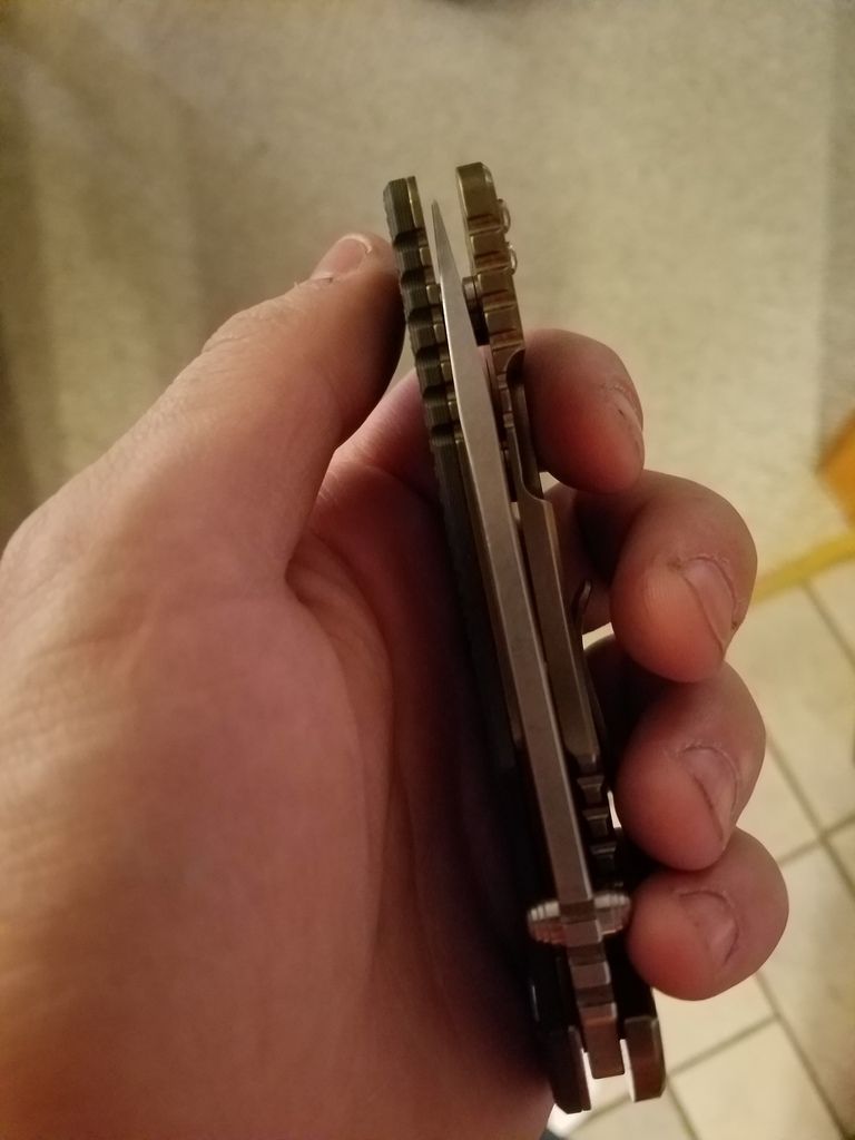

I think there is an issue with my knife. My problem with sending it back is I don't think I'll find another one with the combo of scale color, finish, and non flipper. I also think I would like it alot if it functioned properly. I took a little cell phone video and you can hear what I'm talking about. Is there a way to upload that video on here? I have til tomorrow to send it back. I want more input. It it is normal I don't want it. If this is an isolated instance, I want to keep it and have it repaired. Please let me know if there's a way to upload this video for some final thoughts from you guys on weather it's normal or defective. Thanks alot for all of the help so far.
I'm going to attempt to upload this short video. Let me know if I am being dramatic or what. It clearly indicates what's going on by the clicks you hear when I push on the lock bar a bit then release it and open the blade. Notice when I push the lock bar, the additional force required to open the blade. Hope this works. Thanks.
I see nothing unusual in that video, it's rather common (not necessarily correct mind you) for a frame lock to act in that manner when pressure is applied to the lock bar while closed. ZT 0450 can become fully inoperable if that is done to it for example. I really do think it will loosen with use as the sharp edge of the detent hole wears off to more of a rounded slope.
Bottom line though if you're not happy, send it in and get it looked at or sell it and move on.
After warching your vid I am a bit confused with what is wrong. Can you shoot a video demonstrating the problem you were having, i.e., being unable to thumb open the blade single handedly? When do so, make sure to show the lock side in your vid.
Yes, when I get home from work I'll see about getting a video of thumb flicking. I cut my thumb at work yesterday and it was a bit tinder last night which is why I didn't in my first video but it's much better today.
I will also add, when no pressure is added it will flip out great. Just clipping it in your pocket though, is enough to lock in the detent ball. That is the problem. If I never had to worry about that bit of pressure added to the lock bar then it would be great, but I would have to carry it in hand at all times making sure nothing touched the lockbar if I wanted to use it immediately one handed. I don't see how this could be normal. I'm going to quit complaining and send it to Hinderer. If they say nothing is wrong, it will be for sale.
I got home and started playing with it and I think it is breaking in. Like some have said, it seems like the detent hole is rounding off a bit. This is my first Hinderer and frame lock so I guess I had to get used to it as well. It's possible the very top of my finger was on the lock bar slightly also "hinder"ing the flip ability. I know that was said aswell. I'll eat a little crow and say I'm really starting to like this thing this afternoon. I'm glad I didn't give up on it. I will have some edge work to do, I'll just do it gradually
during sharpening. I can deal with it. I appreciate you guys talking out the issues with me and getting me to a place where I'm comfortable with my purchase.
