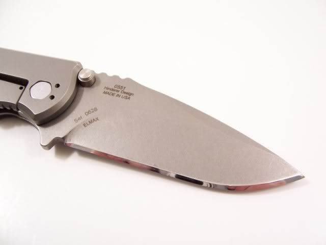

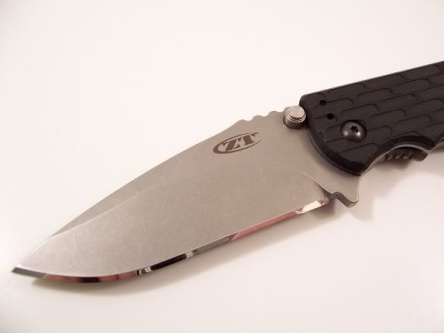

Mine came with pretty uneven bevels also but like you everything else was really nice. I say use it and enjoy it and fix those bevels later. Mine looks good now.:cool:
Ive Polished some edges before on my edge pro , but never quite that good ......
Great lookin edge .......... dj

Yes, opinions are welcome and I appreciate yours. I have a fair amount of time on the EdgePro, with successful results. I'm still kind of on the fence though.
prime77,
What's your succession of stones and polish tapes on the ZT0551? I have an EdgePro Apex, so I only have up to 600 grit. I do have 3000 grit polishing tapes. I don't think I can get mine to the level that yours is on. I need to order a couple stones and some higher grit tapes from Ben when I get a chance. Did you strop with diamond paste after sharpening on the EdgePro?
Wow, prime!! That is not an edge I have the time or need to put on my blades but it sure if beauty!!:thumbup: I've done it in the past, but yours if just gorgeous. My knives would have that polish ruined before noon of the first day's use so I don't put that type of edge on my users. I like to play around with polishing edges for fun sometimes.
Excellent work!
I used DMT Stones Coarse through EEF. Then polished the edge with DMT 6,3,1 micron paste on leather. Lots of patience and I have been touching it up daily on the 1 micron strop so the edge finish improves each time. I have to say I'm pretty impressed with Elmax. It seems to hold the razor hair whittling edge alittle longer than I expected and takes a really good polish.
