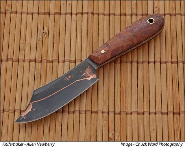

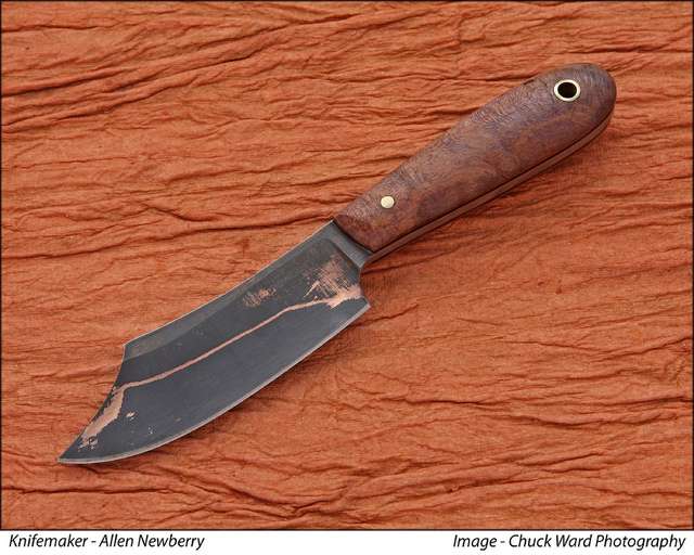

I finally had some decent pictures taken of one of my knives. Here is what Chuck Ward was able to do with my pocket cutlass. The knife blade is 1095 with an edge quench and an etch in a solution with copper and brass mixed in. The handle is stabilized cherry burl.
What I did was use ferric chloride that has been used to etch a lot of copper and brass. This coated the entire blade I then rubbed off the rest of the coating and on the quench line it was quite a bit more tenacious so it stuck around.
hang on can I get some more detail on that copper etching process.:confused:
it seems to me that it could be a nice way to increase the corrosion resistance of a knife.

That is one killer blade finish, I like that lots!
Thanks! I guess since I posted this thread two years ago I could give you guys a bit of an update. First off, I still love the design and carry one quite a bit myself. Second, I try not to do that blade finish very much anymore as it tends to take several tries for me to get it right with sanding in between. last time it took seven tries! :eek: Finally, this knife was the first that I ever had professionally photographed. It also became the first knife of mine in a magazine, first knife in a book, and first knife in a calendar. If there had been no professional photos none of that would ever have happened. Thanks Chuck!
