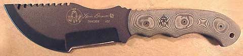

So, I was using a friend's Tom Brown tracker knife the other day, and very much liked some of the features such as the quarter-rounder. However, the knife seemed like a poorly designed fighter rather than a chopper because of the up-swept slashing point (see fig 1). I decided I wanted to design my own interpretation, so here its is (fig 2). I'm an inexperienced knife maker and designer, and I'm not ready to take on the project yet, but I'm ordering steel in a day or two and wanted to know if this design was viable an worth making. Please criticize...if its total c**p, tell me...
