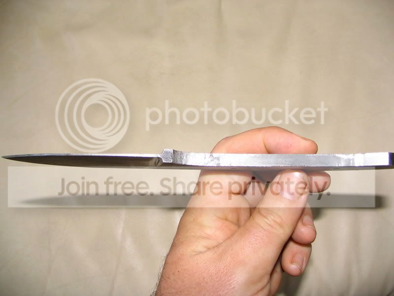

Hi all,
I've got my bevels filed in now, and I have some more questions:
-Is the edge thick/thin enough for heat treat and cutting ability? It's a bit thinner than a penny in the belly and about penny thickness at the tip. I'm assuming sanding etc. prior to heat treat will bring it down a touch.
-I was barely able to drill the pin holes with my hand drill, so there's no way I can do more. I've seen where people drill several holes to help with glue adhesion to the scales...how critical is this and will my handle stay together without them?
-How far do you take the finish before HT...I'm thinking about 400 grit or so, but not sure. Also, do you do the same to the handle area, or leave it rougher?

First off, it is looking very nice! You're right, 1/4" is a bit thick for anything that small. Most guys use that thickness for big choppers/campers. Reguardless, great job so far. Your filing work is better than some of my grinding work :D.
Remind me what type of steel you're using and how you will be doing the heat treatment. That can help determine how far to go before HT.
Even so, my opinion would be to take the edge down a bit more with a file. Sandpaper will remove some material, but not enough to really notice, depending on how deep your scratches are. I'd go to maybe half of a penny. Keep in mind that you won't be able to file after the heat treat.
I usually finish to 320 to 400 grit sandpaper before heat treatment to the blade and bolster areas, and you'll likely need to start back at 220 and work your way to higher grits after heat treating. Personally, I just finish the under-scale areas to 400 grit on the grinder, and do the blade/bolster areas by hand. If you've got some deep scratch marks on the handle area, I would go ahead and hit it with at least 220 to even it all out. Use a good wet/dry paper, some cheapo honing or cutting oil, and a backing stick (i.e. a piece of micarta, or even a file with a bit of tape around it). The oil will make a slury while sanding and help to let the paper cut much longer and better.
As for the handles, a few pins and epoxy should be plenty for this go around. I recommend slightly oversizing the pin holes in the metal to allow a little epoxy to fill the gap. I would definately invest in a drill press before too much else; makes things soo much nicer when drilling :). The extra holes help the epoxy have more bite, but with many epoxys running 3500+ psi adhesion, you should be fine.

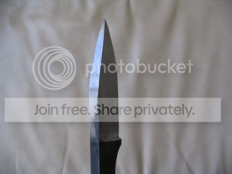

Nathan, the steel is 5160 and heat treatment is still up in the air at this point, so I can't tell you how that's going to happen. The thought of more draw filing kinda makes my stomach hurt, but I'll take the edge down a bit more. The pin material does fit snugly but fairly easily in and out by hand...is that good enough? If not, I might opt to sand down the brass a bit rather than trying to drill anymore with the hand drill.
I was thinking that leaving the handle with a coarser finish, but flat for a good fit with the scales, might help give the adhesive more to grab onto. That's interesting that you take it down to 400 grit.

The only thing I'd add to what has gone before is to take most of the next filing off the one side that isn't as deep as the other. One thing many new makers don't do (and I still fight) is get the edge thin enough. The thinner your initial edge is, the better your final geometry will be. I know how hard it is to get that thin edge, but it's worthwhile. I try to get it about as thin as the cardboard from a new shirt's packaging. I rarely succeed but when I do I'm happier with the knife.

I don't have a lathe, but do have reloading calipers. I'm ~.04-.05 on the belly, and ~.06 at the tip.
