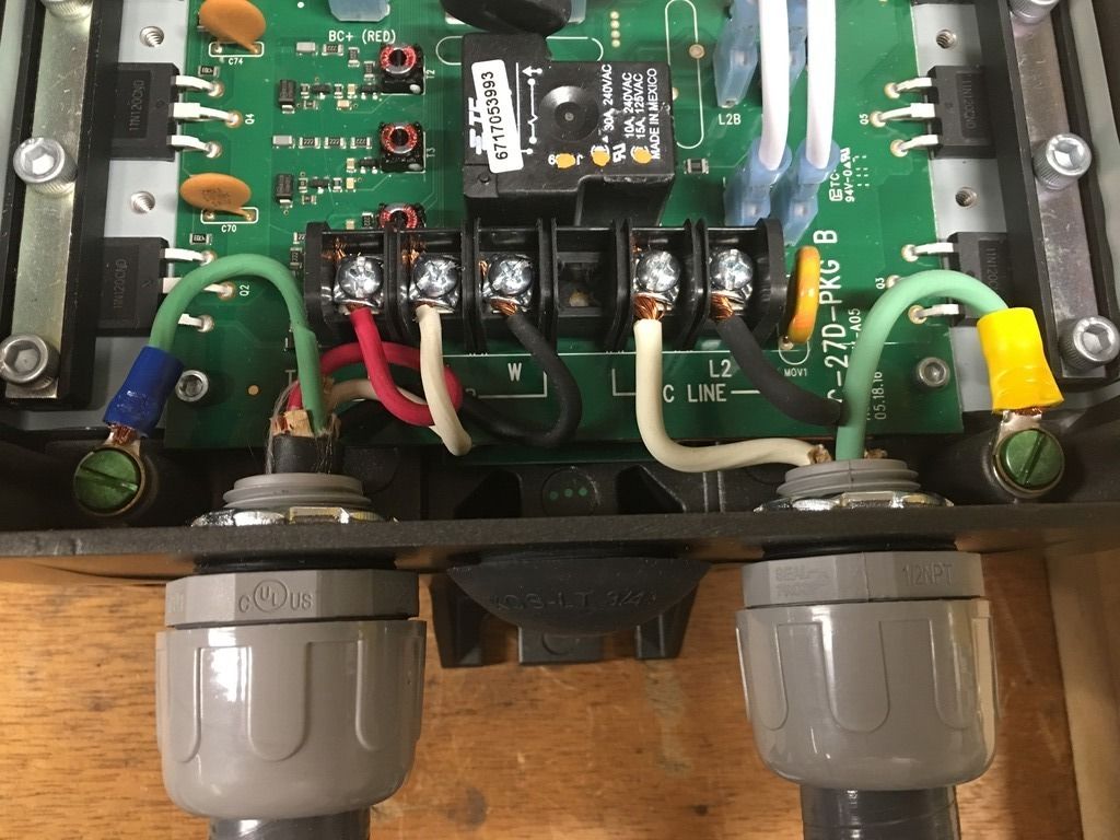

Thanks to all, will go with a 25-30 foot 12 ga wire (maybe 12ga extension cord wire) with 220v as input to the VFD. Yes the motor I ordered is 3 phase.
For the VFD to motor, they didn't have any 16/4 at my local HD or Lowes so I ordered 20' of SOOW 16/4 wire from automation direct, shipped for @ $22 with 2 day delivery ($16 wire, $6 shipping). That is where I ordered my motor, automation direct is fast and efficient.

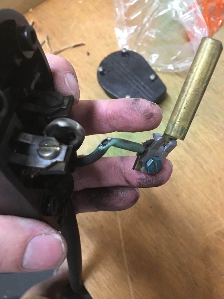

HELP! I hope i didn't just fry my vfd!!
well i wired everything up this morning, and thought i was very careful, following instructions to the letter.
When i went to plug the 220 plug into the wall, i got a Flash POOF when i just started to push it in, and black smoke shot out the bottom of the plug at the wall! i immediately pulled it out. The breaker didn't trip. I used this outlet just last weekend on my table saw, and was fine.
IT appears the ground wire blew apart inside the plug.
my power cord is 30 feet of 12/3, the breaker is 30 amps, which is too high i know but what was in there.
the cord from motor to vfd is 16/4. i wired the motor just like the instructions.
Please help if any idea what I've done wrong or what to look for, god help me i hope i didn't fry the vfd.
more info. It clearly appears the ground wire blew apart right where it was likely touching one of the hot leads in the plug. Not sure what did this, possibly a kink or bare spot there, but who knows. Looking online it appears the 12 gauge wire is not big enough for a 30amp breaker which may have contributed to the issue? I have been using a short 12g extension though this outlet no problem with my table saw though.
I am going to get a 20 amp breaker, which is what i should have had from the beginning, and rewire another plug (carefully).
I hope it did not fry the vfd, i don't see anything suspicious looking there, but guess will find out soon.
If any other ideas or thoughts, or things to look for, please let me know!
The more I look at it, I am suspecting that when I screwed the 220 plug back together I could have mashed the ground wire against one of the hot leads. I remember it was harder to screw together than the last time
Great news!!! It works! It was a pinched wire in the plug, vfd seems to work fine!
Got the 20amp breaker in too.

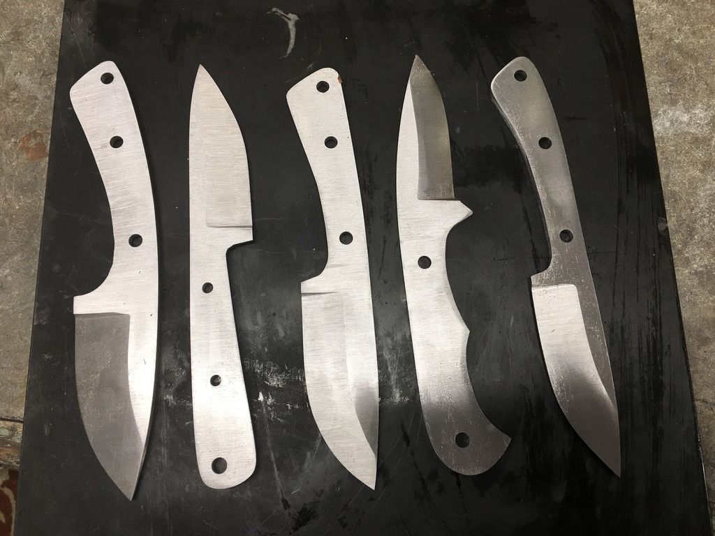

I am so happy with my grinder and vfd setup. I am very impressed with the precision and control, and speed at which you can shape metal with this setup, esp compared to my 1x30 HF sander. I'm also surprised at the lack of dust, had a bowl of water right under it, and most went in there. And, for sure the variable speed is definitely worth it. This setup will save me a lot of time and help me make better knives. Thanks!
I had a few of these already rough shaped, but this morning completed a few and think I'm ready for heat treat. Thanks again for your advice!
