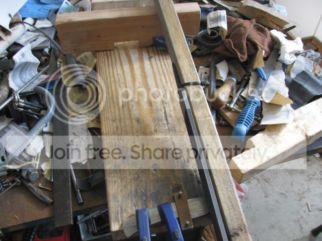

This is my setup:
That's a 2x3 pine board clamped to an L-bracket (?) with a hand bastard file zip-tied to a 1x1.

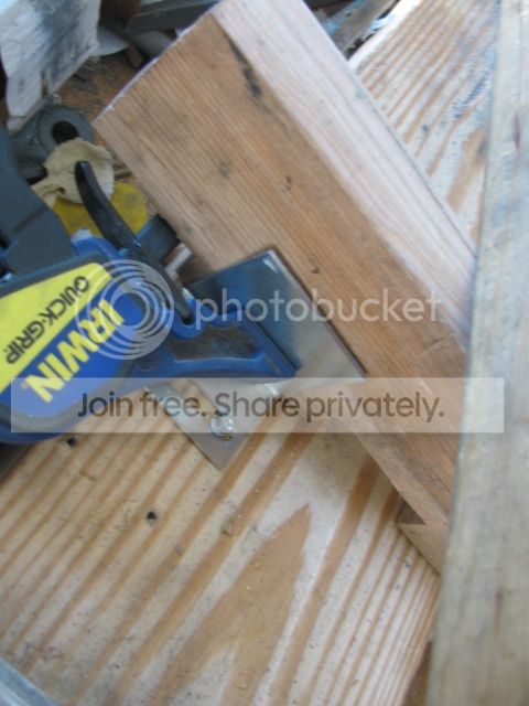

Here is a closup of the bracket
It is screwed into the board and there are holes drilled along the board to correspond with my most common bevel angles.

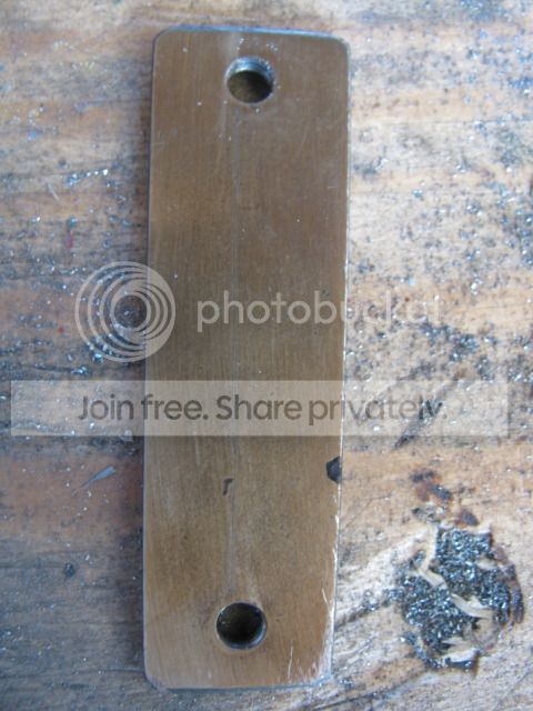

Here is my file guide:

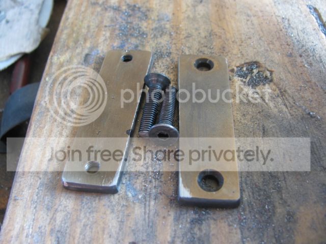

Two pieces of hardened 1084 attached with two flat head bolts.

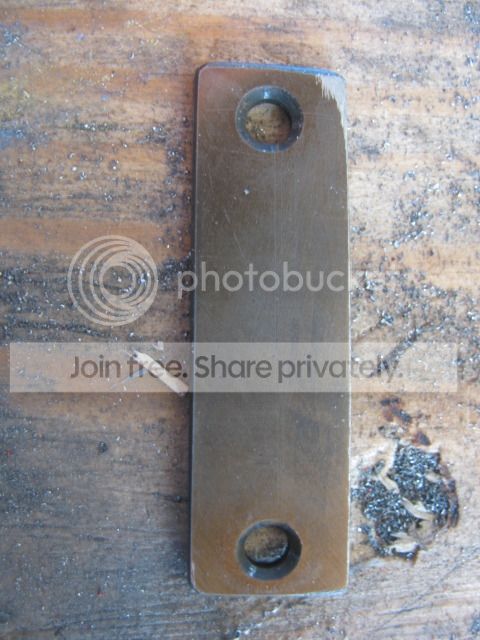

One is drilled with a #21 tap drill and tapped 10-32...
And the other is drilled with a #5 tap drill and countersunk.
Bolted together with 2 of these (there's only one in the photo though)

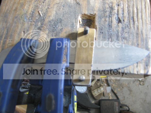

And I attach the knife like so:
Notice the chiseled out channel, this is important.

Thank you both, I have already read both of those and many more probably one hundred times. The one thing I dont like is that when I do my filing I want my bevels to come out even, if i do it by hand it seems mediocre at best, it is tough to get the angle the same with every stroke. I cant find a bevel jig for a file anywhere online either??? also I cant find how to make the bevel grind radius, where the bevel starts to curve and drop by the ricasso, i dont know if I am explaining it right.
Have another look, Taken from that link
You will have to make something, never seen one for sale
Hand Tools
You can do it all by hand with files and abrasive cloth like the Green Pete video.
Files can be made from unhardenable steel, or steel similar to 1095 that needs a difficult HT
Just use 1084 instead of a file.
Photo of a nice bevel filing jig
http://www.flemingknives.com/imagesPrime/FileStation/KPicB007.jpg
Http://farm9.staticflickr.com/8486/8152684286_312b9fc8da_b.jpg
plus
http://www.knifeforums.com/forums/fbbuploads/med_1296162371-Filing_Jig_001.jpg
I know a filing guide seems like it will do the job for you, but consider that while maybe thousands of knives have been made with a guide, many millions have been make by hand filing. It only takes a little time to get the hand movements down. All the jigs in the world won't teach you that. The biggest thing is a full straight stroke, lift the file and return to the top, stroke again - DON'T SAW BACK AND FORTH!
Thanks you guys very much, and I did see the link in the sticky but I thought that you could just buy them I didnt know they had to be made. Also after reading bladsmth post i will just do it by hand and learn
The one tool that helped me alot was a 4x36 belt grinder . They are about 100 bucks at sears.It will save you a BUNCH of time!!
