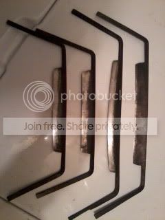

I've made a few knives successfully but I'm still very green. Up until this point I
made my knives from old files and haven't had any problems.I bought some steel from admiral steel to help save some steps and searching for old files,I thought 1095 would be the way to go,but I seem to be having trouble hardening it! I've always hardened my knives in the fire pit using apple and hickory and a vacuum cleaner as a bellow,and did the same for the 1095. I got it as hot as it would get and it was a glown' ,I then plunged it into pre-heated motor(150.f)
I don't know what went wrong,but I'm guessing it wasn't hot enough? Any help would be great,thanks in advance! Ronnie
1095 requires a far more precise heat treat than you'd expect, given it's reputation as a simple steel. It should pretty much be exclusively heat treated with at a minimum an electric kiln (need to be at 1400-1450) and purpose-made quench oil, such as Parks 50. If you want to heat treat with that set up, get 1084.
I am not going to go into specifics, but 1095 requires a HT where it is brought up to a bit above nonmagnetic and then held there for 5-10 minutes. It is not a simple steel to HT. here is a link to basic HT info: http://www.bladeforums.com/forums/showthread.php/673173-Working-the-three-steel-types.
You will be much better off with 1084. It is basically impossible to HT incorrectly, as evidenced by the fact that I have made few blades out of it and they work :p. However, since you have the 1095 already, I would recommend putting a location in your profile. you never know if you live 10 minutes away from a master smith who would be happy to help you out with HT.
Motor oil will not harden 1095 as hard as it should be, or needs to be, and bear in mind that a file will not tell you that it is just because it won't cut the blade. You will have a mix of martensite and pearlite at best, and the file will skip on the martensite without cutting into the pearlite, making you believe the entire structure is hard when it really is not. I would suggest packing the 1095 away until you have the means to HT it right, or selling it to someone who does, and buy some 1080/84.

As you already know, your HT method won't work well for 1095. It would work better for 5160.
The stickies have a wealth of info on metallurgy and HT.
While your HT method is primitive, serviceable knives have been made with the same setup. Adding a magnet on a extension rod ( extension pick-up magnet from HF) will help you with guessing the heat range.
Canola oil will be a better quenchant than motor oil.

Thanks for all the lowdown on 1095! Its obvious I bought the wrong steel for a beginner,but I've already spent alot of time on these knives(4 draw knives) and would really like to finish them up. one option is to send them out for treating ,but what if I bought a kiln and the right oil,can a novice properly HT them?
I will be parting with the 1095,I have a 2x3/16x72" piece left!!
I was going to post some pics of the knives but I don't see a link.
Does anyone live near Worcester Mass that could help me? I'm really in a bind,I'm making these knives for friends and I don't want to delay them longer! I could mail them out,but if someone lives nearby it would speed things along. I would be willing to trade the piece of 1095 for it!! Ronnie
Spend about the same $ as motor or canola oil for that matter and get some Fast Quench oil from McMaster Carr.
They have a warehouse in Chicago and should deliver in a couple days. Will work great (Have used it a number of years) and they have the best customer service around. Remember the 11second fast quench and get your blade to Non-Magnetic and dip in Pre-heated to 130-140deg quench oil. cold oil WILL NOT work
