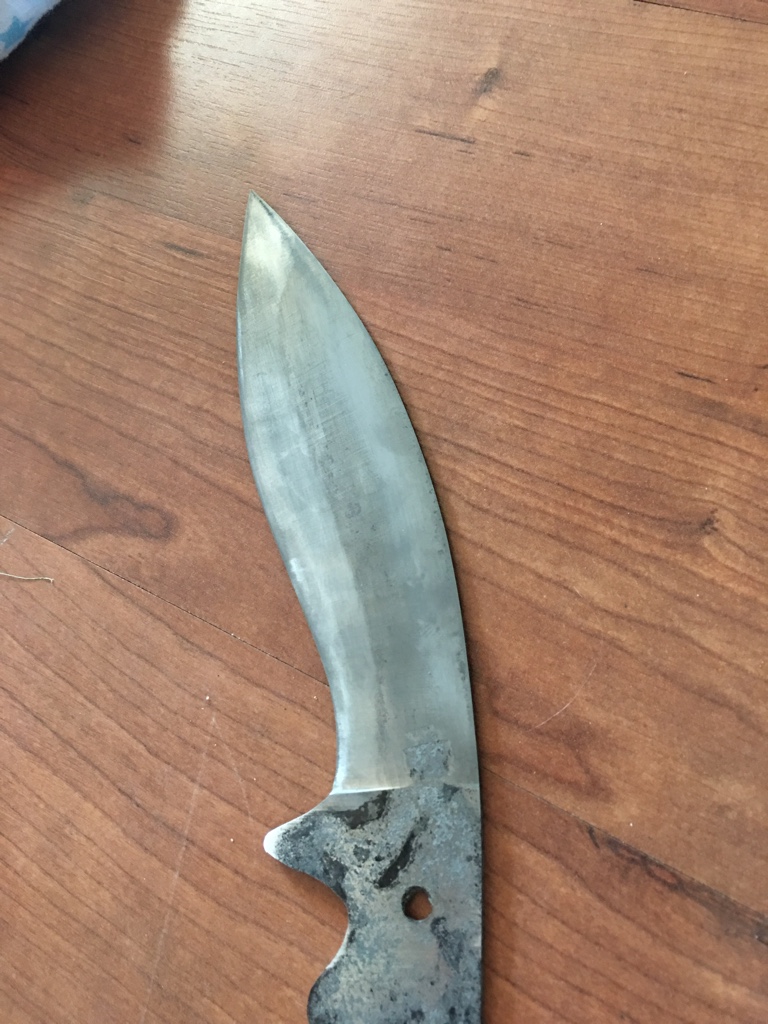

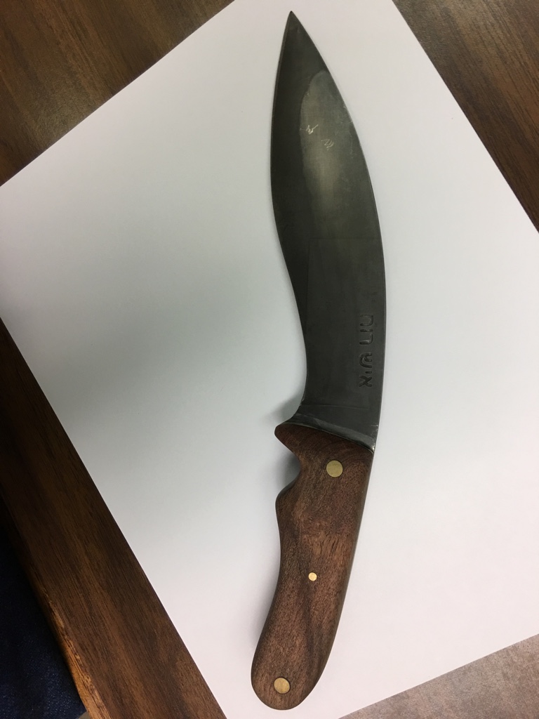

This is 1095 that I quenched in McMaster Carr 11 second oil after hearing to non mag and soaking just a couple minutes. I coated with caulk style fire block and got a good hamon on it I think. This was only the second knife I have made.
That's Great! You etched/patina'ed it quite a bit by the looks of it?

Used ferric chloride acid and some vinegar to etch it. That picture makes it look darker than it is. You could see the hamon all the way to 400 grit polish before I etched it. I didn't think it was too hard really for my second knife.
