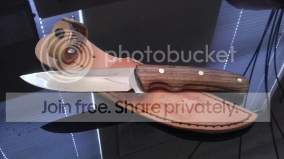

Greetings all. My name is Josh. I've been lurking around these forums for the past few months soaking up as much knowledge as I can and last week I started on my first knife. Progress is going well. I started with a pre-made blade from a local shop here in Houston and bought the scales separate. I thought this would be a good starting project based on what I'd read. I'm now to the point where I'm about to put a final sanding down on the wood handle scales and afix them to the tang. I just had a few questions about how to actually finish them. I would like to stain them darker, is that appropriate for such a material? Would/should I apply a clear coat or lacquer to the outside before or after I've fixed them to the tang? (I would do a final polish by hand afterward as I don't have a wheel. I work in an apartment shop so most of the work has been done by hand with files and sandpaper. I do have a 1" x 30" belt/disk sander that I've used to flush the scales with the tang, which I still need to polish. Any help you guys could throw my way before I peen the pins down would be much appreciated. As promised, pics!
I switched to Bocote wood handle material because the first scales were rosewood and very difficult to work with with a coping saw, i cut them way to tight to the tang to allow for adjustment.
Test fitting.
Note: gaps are there because the bolts don't actually hold anything together.
Not enough flash :(
Anyway, I think I'm making good progress. I just have to polish up the scales and finish them with something.
Any comments and criticism are welcome.
-Josh

Mark at Burl Source often has a lot of good suggestions for finishing wood. I usually take mine to at least 1200 grit, with a coat of danish oil applied and sanded in when I switch grits. That may be unnecessary with your wood; I can't remember how naturally oily rosewood is. Then finish with a coat of paste wax, although you can carefully paint on some lacquer if you so desire. Keep sanding until all the marks from the previous grit are gone. I also am one of the odd few who epoxies the handle onto the knife and pins it before shaping and finishing the handle scales. Then I can polish the tang of the knife as I'm polishing the handle scales. I just have to make sure to tape the blade heavily around the ricasso to avoid scarring it. Good epoxy is good too. Lots of folks recommend Acraglass.
Thanks for the tips, if I can finish the wood with the pins in then I might just do that. Do you work the wax in with a wheel? Can that be done by hand? I guess I wasn't specific when I mentioned that I switched materials, I'm now using a Bocote wood. I'll update the OP.
Nice, I love bocote. I use that extensively. I find that danish oil is a good thing for bocote. Being such a dry wood though, it will warp if you take it somewhere wet, just FYI.
It will take a good sheen on it if you take it to high grits. Also, the figure in the wood responds well to texturing, as in my last picture. Not sure if that's something you want to do, but it's fun stuff to work.

From what I can see, it looks like you are using screws as pins? I would definitely recommend getting some brass or stainless rod for your pins.
For gluing, I prefer west systems gflex epoxy. Lots of people swear by acra glass, but I have never had a reason to try anything other than gflex.
Bocote is a very easy wood to finish since it is so oily. Just work your way down through the grits.

Just wanted to throw down an update on this old thread since I'm about to start a few more projects. The knife turned out pretty well for my first.
