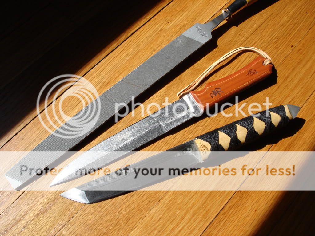

I do not have access to all the propper tools and materials right now, but useing a basic large belt sander I made these out of a couple of mill bastard files...

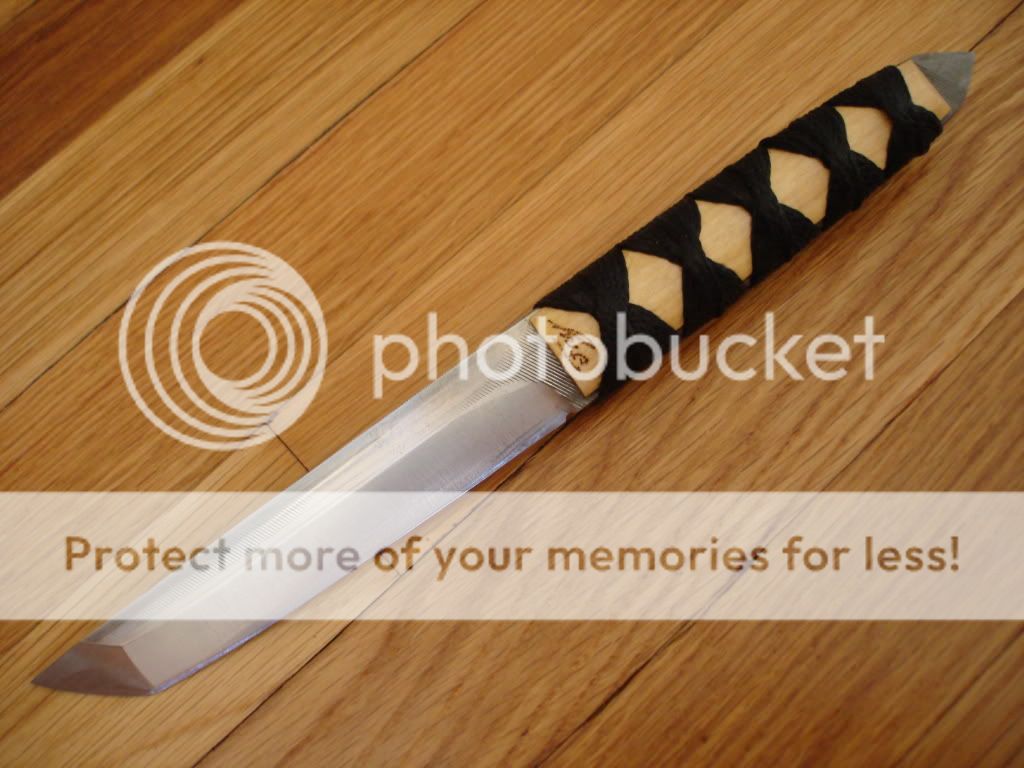

My first knife ever:

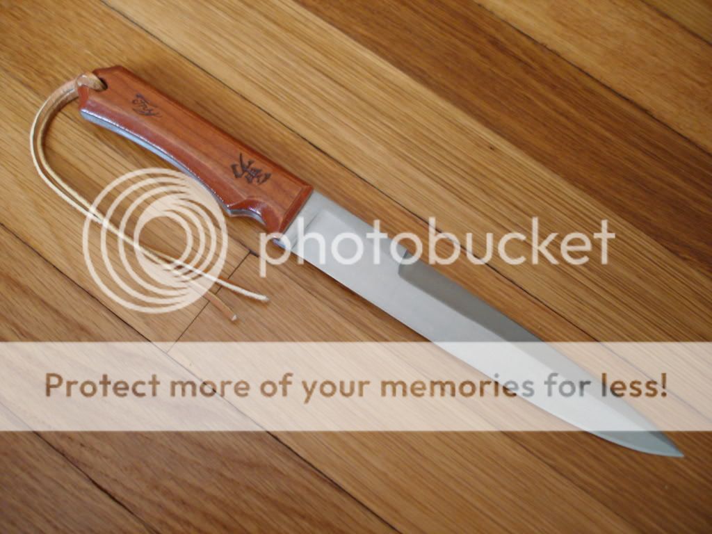

and my second attempt:

im new to the knife making my self i know about ugly me made knifes to me your on the way with few tools it looks pretty good to me hope everyone well give you some good info
Not a bad start.
If it's something you enjoy there's no way you can go wrong.
Keep at it. :thumbup:
that you stated you were a huge blade lover is underscored by your effort in designing and making these two. You are walking the walk.
Great first effort man!
In my opinion you did very well.My first and second knife were not this good.I hope we'll see more in the future.
G
Keep at it! I wish my first couple of knives looked that good. Good work!
