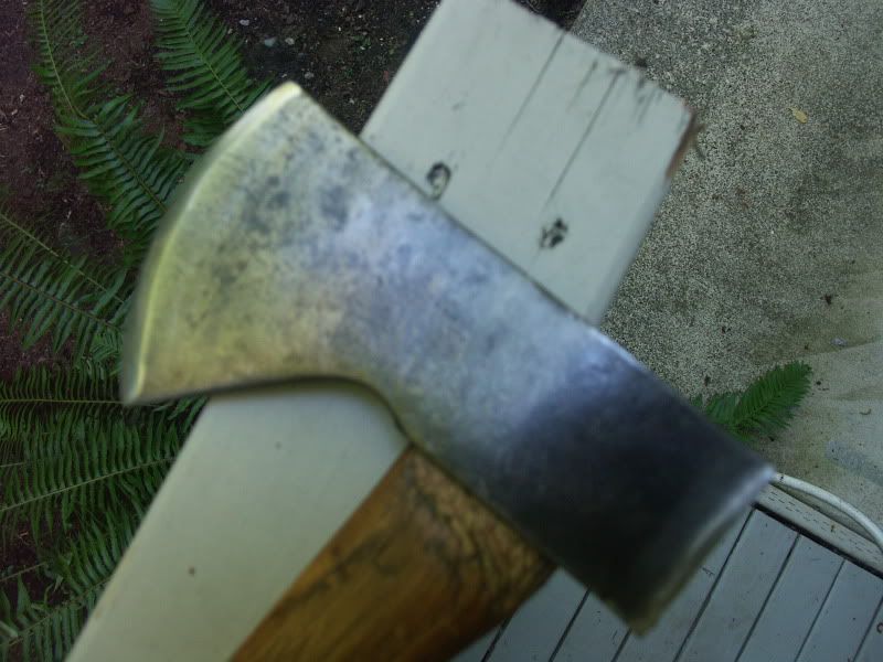

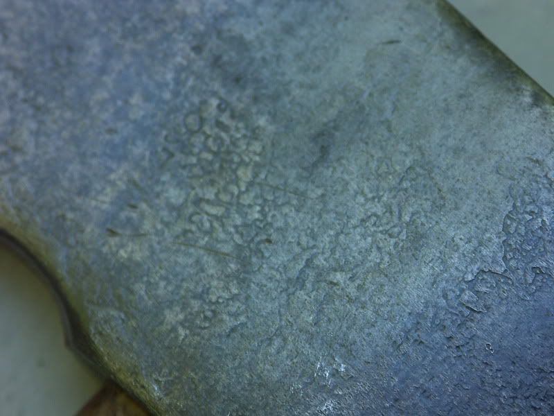

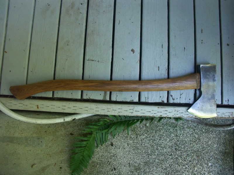

With no markings it's anyone's guess where it was made. But it looks like a vintage piece and that bodes well. The substantial poll should give it good balance. I think a file will tell you everything else you need to know.
If you take a fresh high quality file to a well made axe it should cut with some difficulty - i.e. the pressure and stroke need to be right and file must be kept clean. If you can cut the bevel with a worn or dirty file then it's too soft. If it cuts very easily with a fresh file then it's a too soft.
what Square_peg said. a good file will dress up the edge. if the file really eats up the steel the edge is too soft
nice looking Hudson Bay axe
buzz
Interesting finish. Looks like it could be of German manufacture.
