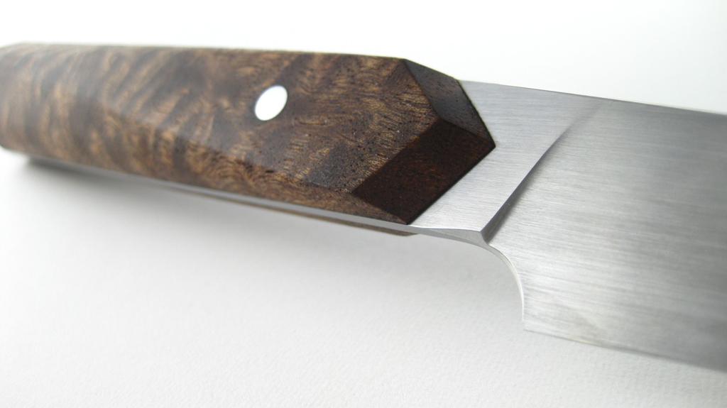

Looking real good Don! :thumbup:
Can I ask how comfortable are those angular features on the handle for extended periods of use?
I might not be the right person to ask since I made them, but I think they're really comfortable. The angles on there are pretty similar to the standard octagon handles, just with a large taper and rounded bottom. Everyone has different preferences but they've been well-received so far by users :)

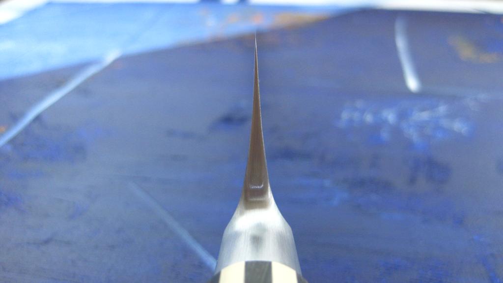

So, as far as the newest 3, the one in green and black are pretty standard 240mm gyuto. The green one has a slightly thinner grind, but they both have 3mm spine thickness at the heel, tapering to about 1mm towards the tip.
The Big Red is 255mm with a skeletonized tang to get the handle as light as possible. The knife overall isn't that heavy, about ~200g, but I wanted it more blade heavy. I got that effect pretty nicely:

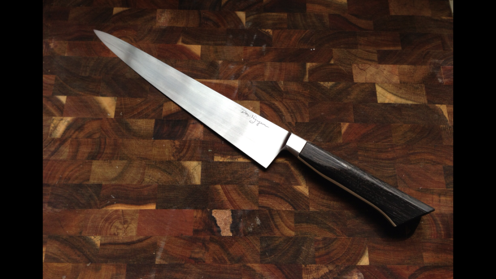

Of the previous ones, they're all fairly standard except for the long integral one. That was actually a forged blank from Sabatier in the early 1900's, I think from Theirs, France. It was probably the most difficult piece I've done because I didn't plan out my steps that well and I've never done a bolster like that before. The handle was also really, really challenging, since organic isn't really something I've done either. I'm a stickler for how things look and also for how they handle, so I spent a long time thinking through the design. Overall it's probably the handle I'm most proud of, and truthfully I don't know if I could pull it off again for a while :) It feels good in all sorts of grips, from pinch to hammer, which was the hard part for me. Here is a picture of it in Australia, where it shows the profile better:
