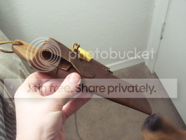

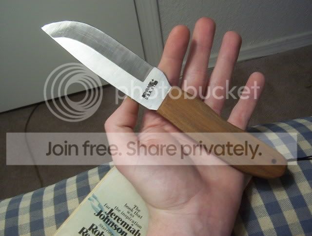

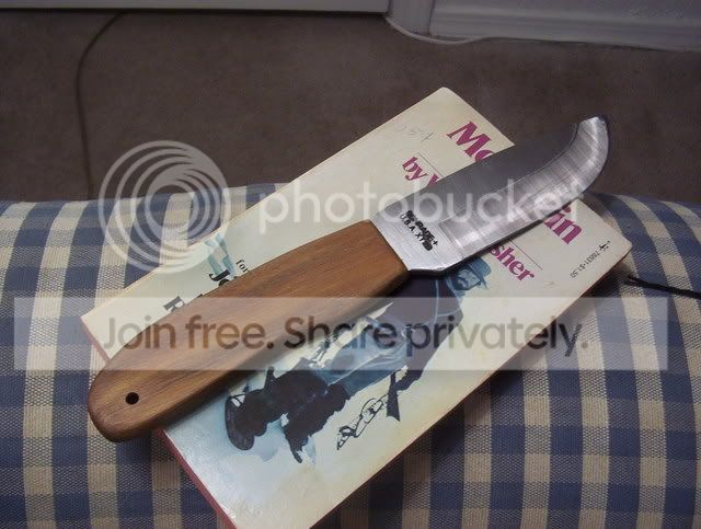

Howdy folks-
Just wanted to share a blade that I finally finished up. The blade itself and the slabs used came from a christmas knife kit I received, as did a bit of the leather. I'm pretty pleased with how it came out, except for a few details. This was my first time adding a handle to a knife. The next will likely be a full tang.
Tools were all hand tools, except for one time when I used a dremel. This was to sand out and perfect the inner cuts, because the hand tools weren't cutting it there.
The slabs are only held on with epoxy (2-ton superglue 30-min set epoxy) since I don't have a drill press and doing pins with a hand drill scares the crap out of me right now. That'll probably happen next time, and with a vise. I believe the handles are oak, can't recall exactly...
The blade itself has some dings and scratches from the factory, and I haven't cleaned it up yet.

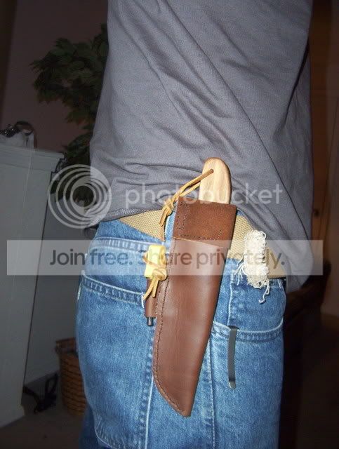

I just finished the sheath this afternoon and have had a chance to wear it around and make up my mind about it. Turned out ok! It carries great. The package is very light and comfortable, it doesn't get in the way at all. The thinner belt loop allows for a more easily self-adjusting fit.
The main leather is about 1/8", and the mouth was reinforced with a piece of 1/16" leather folded over it. The belt loop is also the thinner stock.
Both the blade and firesteel are held quite well, only a definite pull would remove them.
I got to work with the blade a bit today out in the backyard, and it made quick work of some wood. It is very comfortable for carving and easy to choke up on. A distal grip is also secure and allows that light chopping that's useful for clearing tiny appendages from branches. The spine is very square and sparks the firesteel great, and is awesome and wearing down bark or forming wood. Making a quick trap from some stick was a quick and easy affair.
Thanks for looking! :thumbup:

Thats cool Spooky. You know what I like most?? That you did it!! Nice. Isn't it fun to cut stuff with your OWN tool!! Neato feeling.
Now, a few criticisms. Round those handle corners!! Think of a hammer handle. Ever seen one with square edges?? Your files are your friend!!

Thanks Andy! It really does make the blade better, makes me want to take it over other factory ones. I appreciate the advice!! I was concerned with the 'squareness' of the slabs myself. The project was a little iffy at the beginning because I wasn't sure that the two would be thick enough by themselves, with no full tang separating them. They're still a bit boxy, but surprisingly comfortable. The next handle is going to have all sorts of sexy curves on it! (Honestly, I'll be stealing lots from what I've seen off your stuff!)

8-9oz veg tanned leather is the standard for sheath making.

Spooky, the leather is weighed by the sq. ft. I believe. 1 oz= @ 1/64" thickness. So 8 oz would be about 1/8". Many people use the 8-9oz for sheaths. Some use heavier. I think all of it is overkill, as I have scandi knives w/ about a 2-3oz sheath, though it is lined. I don't know how many people would agree with me, but I have been using 6-7oz for the last several sheaths I did, and I like it a lot.
As far as the puuko, there is a reason many of them have sectioned handles. Not only can you make them fancy, it is easier to cut the tang hole in them, or so I am told. I have never done a stick tang yet. Have fun on all of it though.
