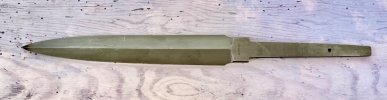

Next build 9" dagger, any suggestions?

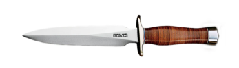

I think a Randall Model 2 - Fighting Stiletto style of handle and guard would look lovely on that!
I never thought of that, now that is a good idea. I also have a 5" boot knife dagger blade that could also be a candidate for a Randall model 2 fighting knife handle.Screenshot 2026-02-10 at 5.01.41 PM.pngIMG_9446.jpeg
If it were my knife, I would want it to have a more reduced guard than the Randall quillons above. Just enough, I suppose, to prevent the hand sliding up. Like the Randall, though, I would want to have a flattened grip so as to index the blade for slashes and cuts.
Then, again, I have mostly given up my dagger collection because of a lack of usefulness (to me). Still, I look forward to seeing how these two turn out!
