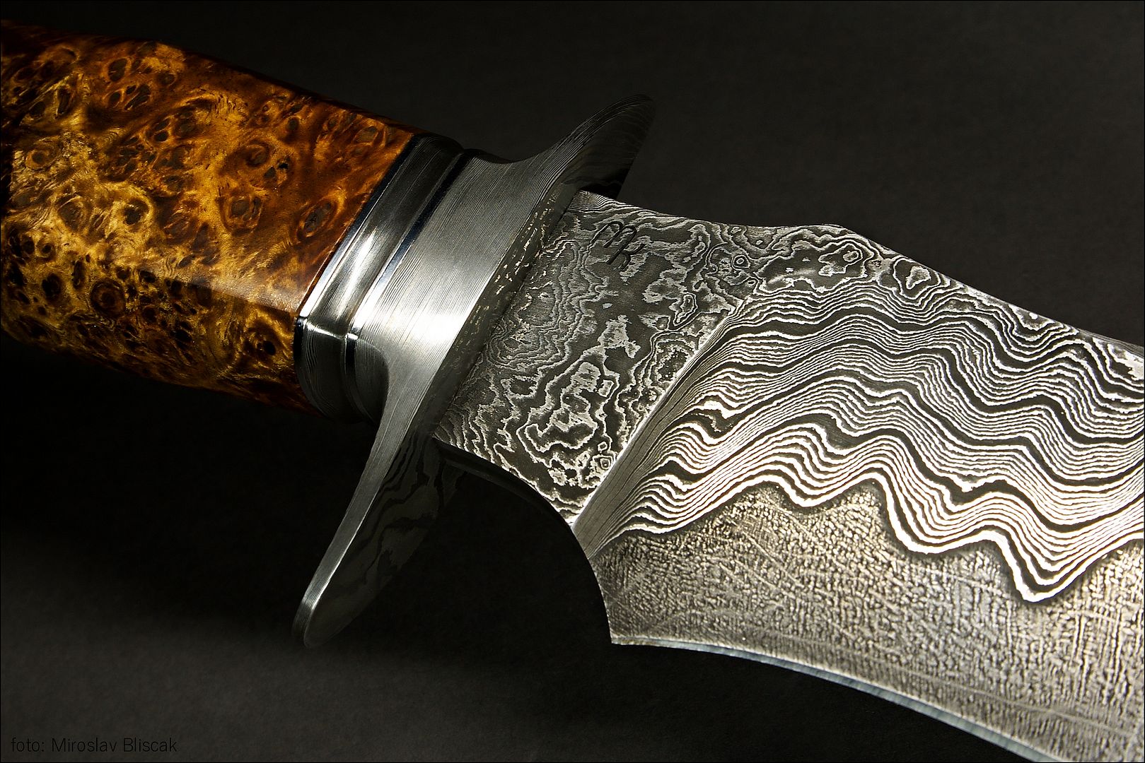

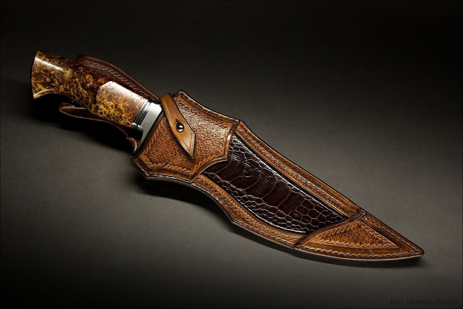

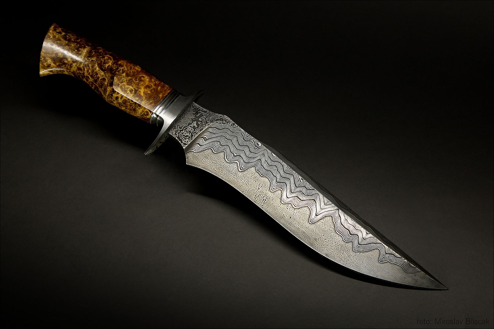

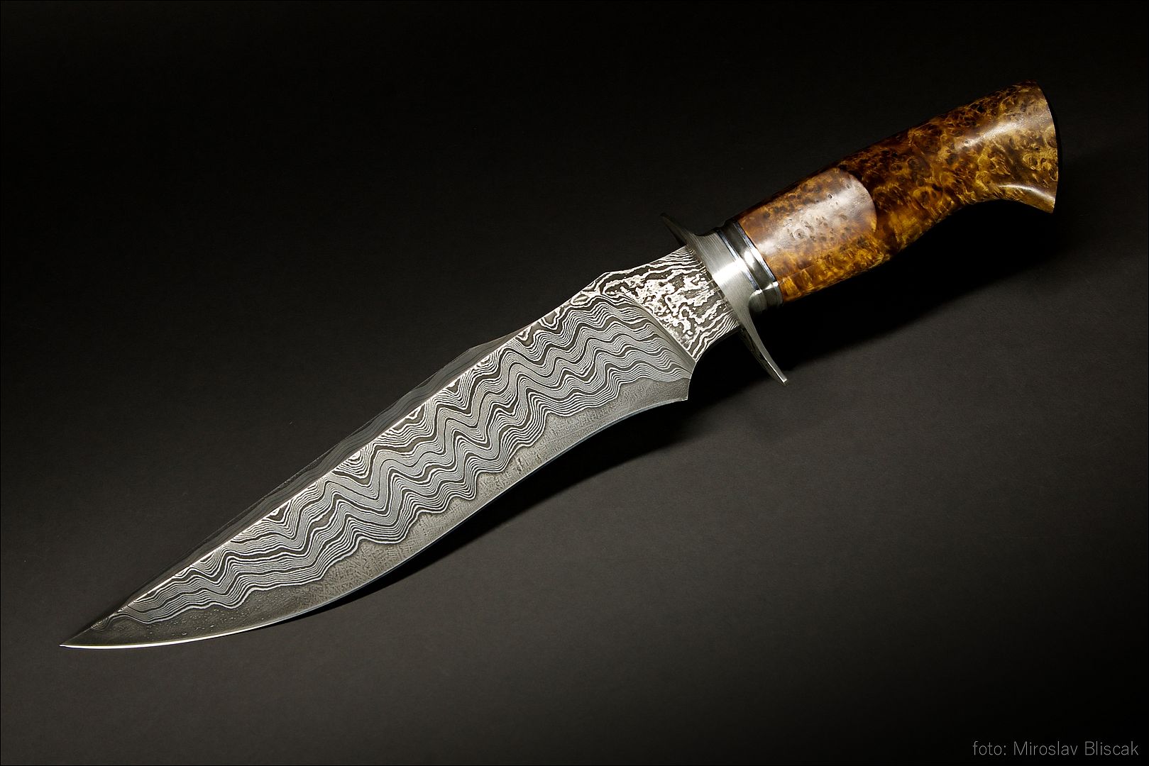

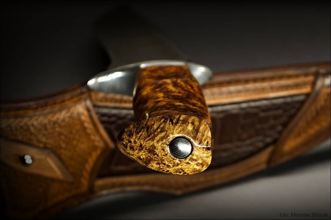

Hi everyone.
I´m make again some new knife in my workshop.
A few basics about it follow.
_The blade itself is made from sanmai damascus steel.(K600 +K720 in core)
_Blade is hardened to between 58-60Hrc.
_Handle is made from stabilized Amboyna burl and damascus guard.
Blade is through hidden tang knife that is tightened by a nut from the pommel.
This is then hidden with a plug of matching material.
Sheath is made from cow and ostrich leather.
Thank you all for looking.
