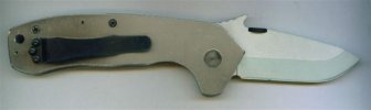

I have had this one here like a lot of these now, for quite a while.
It is next on the chopping block so to speak, so may as well try to convey what I intend for this one.
I will if I succeed not only convert this one to a frame lock in .140 thickness but I will also be tweaking the handle shape again with this one for yet another first.
In the end it will be a redesign of the pivot end of this folder effectively doing two things at the same time at the request of the owner, Friz.
I will be extending the front of the handle to cover the blade more where it exposes the lock contact area. Many of you 14 owners will be familar with this area if you have noted a sharp area near the contact where the blade just barely hangs over the liners and scales when the blade is closed. (see pic).
My new scales for both sides will extend farther out and more than is needed because the end result will be enough to make the blade measure at or very near a true 2.5" blade length which will hopefully make it a legal carry folder in the city limits for the owner where he resides.
Stay tuned. Lots of work but it should be unique and challenging if I have my way here with yet another Emerson in a long line of them.
You'll have to excuse the fact that I'm using my own 14 for the pic here to show that area that sticks out the front of the folder. In person it is much more noticed in my opinion. Anyway, I've already disassembled the folder I'm working on and it was easier to just snag a pic of my own.
Thanks for watching.

Well underway with this 14 today.
Turned out to be pretty nice here. Got up to like 76 degrees at one point. Nice day to air out the shop and open up all the doors blasting all the fans on high. I like!
Anyway, here are some shots showing this one nearing completion. I'll mill the lock out tomorrow, and probably finish it out unless I run into something.
Both sides measure out to be .138 thickness. One the slab lock side of course. The other the non lock which is two pieces of .069 material. One titanium for the liner and the other some of that teal green textured G10 I snagged from Halpern. Nice stuff. First time I've used this one in this thickness.
Love the texture on this G10 too. That makes a lot of diff in the handling so I'm glad I decided to use this for you Friz.
Blade measures just a hair under 2.5" opened now which is what the owner of this knife needs and wants. You can see the difference from the original to what I did in these shots. Just a slight tweak to make it legal is all it took. Personally if it were mine I'd take that point back a bit more but for his request it has to stay.
Weighs in at 5.3 ounces which is up from 4.6 before starting this project. Not a bad trade off since its not really all that noticed at all handling it.

Well the CQC14 city knife is all but done. I now get to play with it for a few and work it in. Bead blasting all the small parts including the pivot, and then putting a new bead blasted lock side and liner side on it requires a new break in to smooth it all down all over again, and also the detent ball on the lock is activated now since that other one is something I cannot duplicate with my equipment that Ernie uses on the non lock side from the factory knives.
Final weight is 5 ounces for the new frame lock rebuild compared to my own 14 in factory clothes which is one of my Waveless ones beside it here in these comparison scans side by side which weighs in at 4.6 ounces. I assume if my 14 still had the Wave on it it'd be heavier by a little but not sure it would be enough to cause it to tip 4.7 ounces. Maybe. If so its not a bad trade off at all either way. Final thickness of my lock cuts to spring the lock are .064 each at the middle on each one.
As is usually the case whenever I can I have pulled another one off that is not permanently modified. This folder can go right back together as it came from EKI and no one would ever know it had anything other than use done to it.
I did make a new ti clip for this one copying the EKI clip at the owner's request so it would match the bead blast better.
Here are some teaser pics for you until the sun shines. Raining here in Oklahoma presently so digitals not an option at this point. My flash is a waste of uploading so its gotta be sunlight to get those. Friz give me a call. We'll go over some things I want to ask you about.

Beautiful job Steve!
I just got another CQC14, and once I'm back too work I plan on sending this one in for your frame lock conversion. The blade length is why I keep coming back too this knife, as well as the fantastic handle ergo's. The frame lock will give me a nice sense of security over the LL. I may also have you remove the wave nub. I'm not a fan of the wave feature, and if I'm not thinking about how I'm drawing the knife out of my pocket it will partially open. This knife bit me a couple times when this happened.
Anyways as usual beautiful work:thumbup:
Davereb
Thanks. A conversion like this one with both sides liners redesigned and replaced with titanium, and some G10 fit to the non lock side, as well as a new pocket clip is higher $ to do compared to just the lock side I've been doing.
With this one though I eliminate that overhang off the end like shown in the first post where you can see the bump stop area and lock contact area of the blade when its closed in the handle. At the same time I legalize the blade length for most every major city so you can carry your folder there and lastly I also get rid of that unsightly detent ball trail left on the blade from opening and closing it that is plainly visible before my redo.
Basically I fix all the things that I feel EKI dropped the ball on in the drawings of this one. I thought of doing this a long time ago to be honest but I knew not everyone would want to pay for it.
On the Wave. For what its worth. I feel that my 14s took on a whole new character once I removed the Wave from them. I can get my thumb in behind the blade to use them now to really lean into it for a cut that the Wave used to make uncomfortable if not impossible to do and I really like that.
Also, I can't say I've missed the Wave on this model at all because, well, frankly the 14's Wave is not the easiest one to work of all Ernie's knives IMO. In fact its among the worst and one of the ones that requires the most effort on the part of the user to successfully pull off if you ask me and one that when it does catch its usually a partial opening at best. Like you I have a lot of issues with ones like this one that end up being a general nuisance instead of a feature.

Here are those reference shots of the blade length before and after for you Friz. This visually demonstrates the fine line between legal and illegal quite nicely. Not a big difference seen here at all but just enough to get you in trouble in some cities. Reduced from 2 and 5/8" open to 2 just a hair under 2.5" as requested and I even did it without permanently modifying the folder or the blade. :thumbup:
