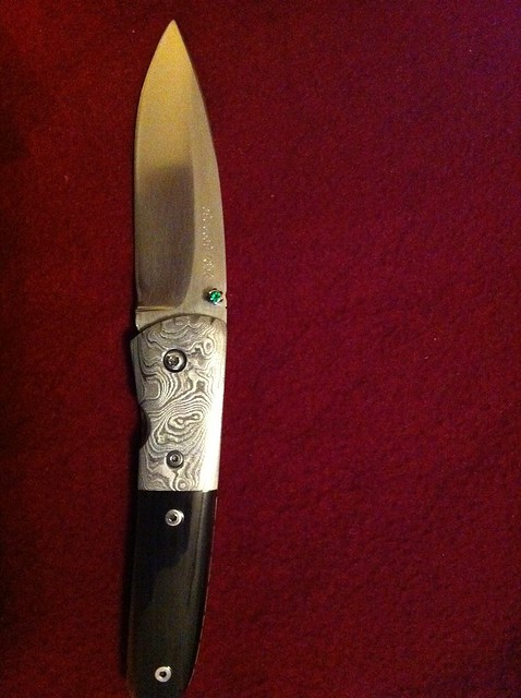

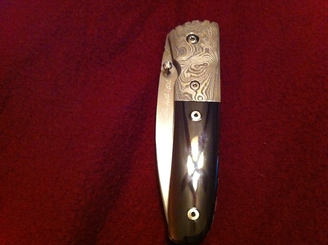

Finished this little knife up about a week ago been pretty busy so I just now getting around to posting it from my cell phone Sorry about the links I'm still tryn to figure out how to just to get the picture itself to pop up from my iPhone. This knife is 7 3/4 overall 3 3/4 blade and 4 inches closed blade steel is D2 .135 thick600grit hand rubbed finish. Bolsters are Random pattern 1095 the scales are buffalo horn jeweled file worked and anodized liners. File worked stainless backstrap. This is one very sharp and solid knife. Thanks for checking it out http://farm8.staticflickr.com/7083/6855013574_373e8975c8_z.jpg http://farm7.staticflickr.com/6107/7001142061_1b4d3e226f_z.jpg http://farm8.staticflickr.com/7198/7001136769_afcf1302fd_z.jpg
