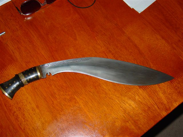

nice watered hanshee (photos)
I believe that this is pattern welded and not wootz. Also, the layering in this blade is "coarser" than what is generally seen in wootz. If fellow forumite Achim is lurking perhaps he will comment ~ he is actually a student of the ancient steel and smelts his own. Yoohoo, Achim, are you out there?:)
From my understanding wootz wouldn't have that kind of pattern to it as seen in the photo.
The current term for 'watered' seems to be 'pattern welded steel'. Two or more types of steel are forged together and then etched with acid to bring out the patterns as the steel is randomly mixed(some smiths can control the pattern to a remarkable degree). Wootz is a rather crude mix of steel that seems to have a high percentage of carbides in it that makes for an incredible cutting edge. Often times it is not hardened and can bend with heavy chopping. It can then be straightened back to origional shape. This is my recollection and my memory isn't photographic. I'm certain anybody with a basic background in metalurgy can fill in gaps.

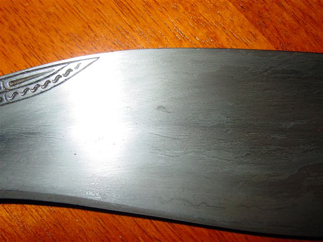

more photos from Rod:
Another beautiful piece!!!!:cool: :D
Rod is there any chance of a full length closeup of the Sword of Shiva on this one?
What I can see of it looks beautifully executed!!!!!!!:cool: :D

Thanks for that Beo, if the Hanshee is pattern welded (I believe it is)
what term would you apply to the second example.
Yes, the hanshee has thicker 'ripples' which I would associate with pattern-welding (though I am not an expert on this topic...).
The 2nd example does appear to be a (very nice!) example of Wootz/Ukku steel, so I would assume any of the 'true damascus' terms could be applied to it. Probably 'wootz' is the best (in terms of accuracy & general currency).
--B.

Spiral, both were as I found them, as per Yvsa's post I dont think the Hanshee has been etched at least in recent times. Rod

Yvsa I may be sticking my neck out here, But by my understanding of Lord Eggerton of Tattons, work is that wootz was etched with "zag" {native sulphate of iron} to bring out the pattern.
Also Lord Eggerton states the ladder effect in true wootz was created by mechanicaly forging 2 different bars of wootz together to achive the ladder pattern. Eg. pattern welded wootz! {double the beuty!}
I may be wrong Rod, but I am, pretty certain yout hanshee is etched, it looks like it to me anyway!:D
