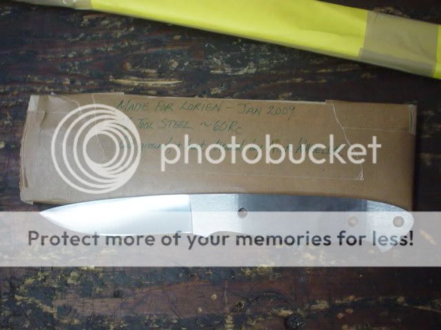

Back in January of 2009, Nick Wheeler very kindly sent me a knife blank.
Along with it, he sent a large file and some 1086 bar stock.
Nick Wheeler sent me off on a journey, and for that I will be forever grateful.

The package had arrived. And I totally had no idea whatsoever to do with it. I had never attempted to make a knife, and didn't know how to start half way.
I have learned that there is great value in 'finishing' a knife. One must interpret the design, because you only get part of the picture; the profile, stock thickness, grind, holes. How to shape and what to use in a 3D context without the forethought of the guy who designed the knife is kind of hard. It adds a whole other layer of learning which is so valuable to the beginning/budding knife maker. Not quite like going to the maker's shop for a weekend but awesome in a similar but different way

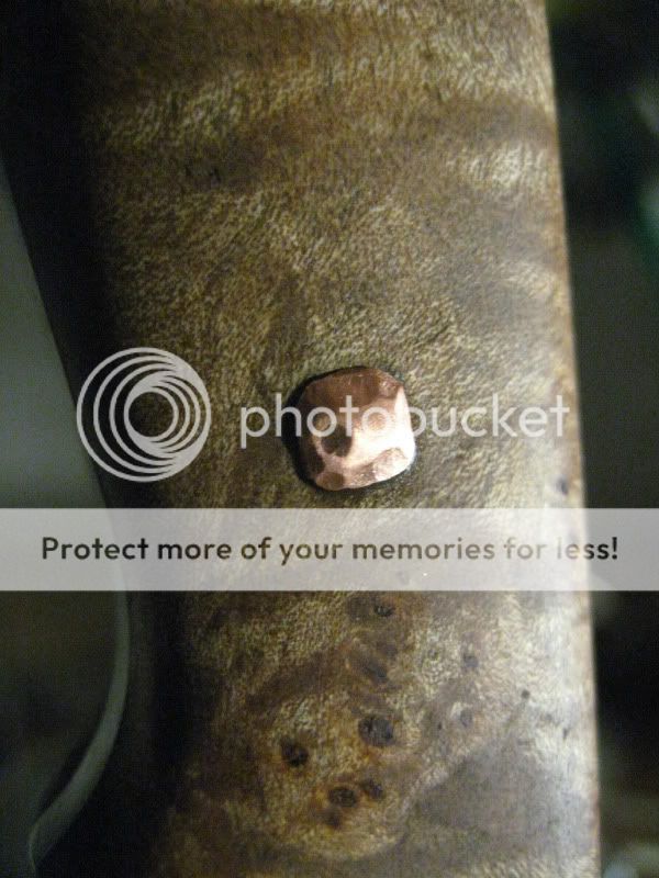

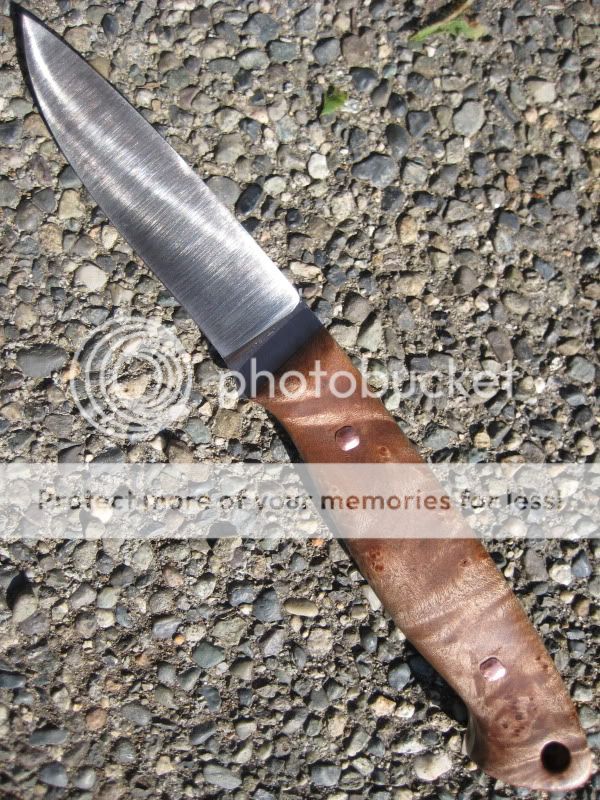

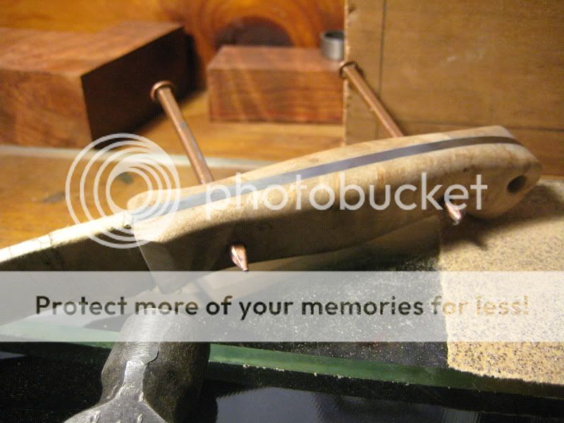

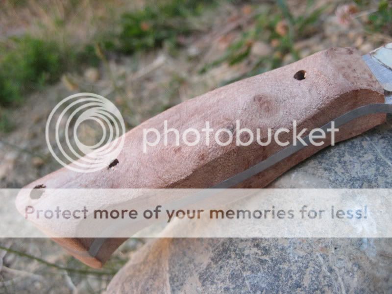

After pressing everything all together with JB Weld overnight, I started filing away with that big ass file that Nick gifted to me so long ago. I have grown to cherish that file, it symbolizes so much for me. Anyway, the sad thing about all this contouring was that I ended up cutting it all off with a saw because the grip was so damn fat. But that experience was really valuable, it was kind of a practice run. So when it came down to doing the contouring the second time I had it pretty much nailed.
Speaking of nailed...

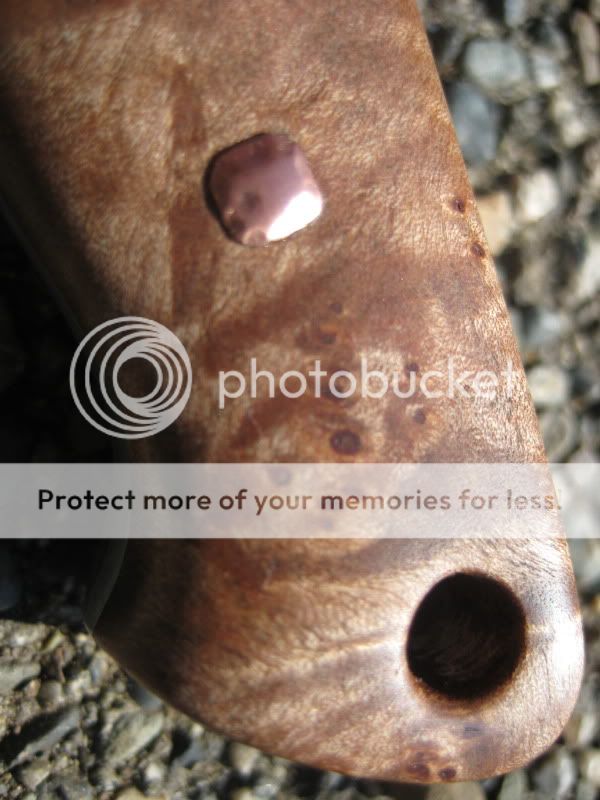

I took this picture tonight. I wasn't going to start this thread until I finished the knife. A lot can go wrong still, and I could totally smurf it up. But I think it's good to see the outcome, whatever the success factor might be. In fact, this job is full of little screw ups already- the holes I drilled in the slabs don't line up with the lanyard hole in the blank, there's still some ugly file marks on the exposed portions of the tang, and the contouring isn't EXACTLY the way I envisioned it. But it's pretty close, and generally I'm stoked. This is the first time I attached a handle like this and I really learned a lot.
So, I got the copper nails stuck through the handle now and the JB Weld will let set for the night. When I looked at the little scene of the knife peacefully resting with its belly full of two part metallic epoxy, I just had to snap a picture, and then it's like, might as well do the thread thing tonight too
