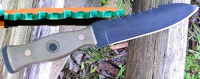

this is not meant to be pretty but as a tool..designed by them and tweaked by me :)
this is a prototype for a Survival school here in Maine it will be tested next week in action,
1095, with Canvas Micarta handle..
The center hole is for bow and stick fire starting holder, the butt end protrudes for hammering on,,
in the production model the handle through the tang and into the Micarta will have a space
to hold fish line and hooks and maybe some matches
I cut the saw teeth like a chain saw would be in this one, with a set
(each tooth is canted out cleaning the side of the blade)
in each tooth so it will have less binding then others you see.. this will saw cut much better than most any other knife will
I'll wrap the handle with Para cord also for use if ever needed...
I differential tempered this knife, the edge and teeth will be harder than
the center of the knife, the center will be more like a spring.
while the edge will be better edge holding..the saw teeth can be sharpened
like a chain saw chain with a 5/16" file.
thanks for looking.. forgive the bad picture:o

That is one very cool knife! Versatile and tough and still looking nice. I just learned how to cut triangle saw teeth for tang hole saws. The chainsaw teeth is a great idea, they look like they will actually cut and not just be decoration.

Dan, did you consider removable grip scales so it could be easily lashed to a pole as a lance. Not necessarily for throwing, but as a stabbing instrument when one does not wish to, or cannot get close to an objective? A little distance is sometimes helpful.
HI Wick,
these are removable ..
the bolts used, are the hiding bolt type fasteners that you grind off flush , I just made the slots deeper on the ones on the other side, (the side that has the alignment tube. )
the ones on the side shown are glued in place,
they did ask for replaceable grips, it's also one of the reasons for the removable parcord wrap I will do to it (not shown:) )

I've spent a lot of time looking at the thing Dan...and to be honest, I'm impressed. I don't really like survival knives because they don't do anything very well. I do like survival tools though.
The pronounced coke bottle handle is perfect for a knife that will be used on both edges. Size seems right and the spear point is again, very appropriate for the knife.
All knives can be used as a weapon but the ones that are designed for fighting, are rarely good for much else. This one is tool first, weapon as a last resort.
Saw backs aren't my thing but using a chainsaw pattern is a stroke of genius. The only thing I've ever found the saws are useful for was cutting notches for snares, dead falls and traps. The chainsaw design should be nearly perfect for that and do some heavier chores as well.

the drop point was to be up higher per the customers drawing but he wanted more strength at the tip so I dropped it some and left off the swage I'd normally put there..I threw a bunch of ideas at him and he liked them..and I'm glad he was open to Ideas..
the saw teach will be a surprise to him though:D I have the handle cord wrapped now with 10' of cord,that should come in handy if needed ...

the blade is just 5/32" I did this for a reason, being a prototype I went light on it test my ability with the heat-treat.
this guy broke a Dave Beck tracker
so of course I'm compelled to make it lighter and hopefully to better his..
