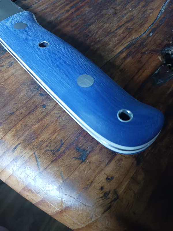

I have never run into this problem before. That is until last week. I have some "antique bone" paper micarta I got from Pop's last year which I finally got around to utilizing. That stuff is *horrible*. Gums up belts damn near instantly and burns almost as fast. After I finished that knife I shelved the whole sheet. It looks very nice, but Jesus is it a bear to work with o_O
You know the stuff. Burns easily, loads belts almost instantly, and a fresh belt is no longer fresh after two passes.
What are your tips and tricks for shaping handle with this stuff? I already use rubber belt erasers but I’ve got a few types of micarta that, once it loads, it’s not going anywhere.
I typically shape with 36 grit AO followed by 150 and then hand sanding.
How can I make life easier?
Thanks!

Thank you for all your replies. Especially the gentleman who mentioned coolant. I tried dipping the handle in a bucket of water before every pass. My grinder only goes at full speed but this new strategy worked really well and I don’t burn it anymore.

I was grinding some of this same stuff yesterday. I’ve worked with it before but I think I learned a few things this go round. If the abrasive loads up it’s going to burn whether you have mist/water or not. The canvas in it is either a brownish/gray color or picks up dirt easily because without any burning it has darker undertones when finished. I had the best luck I’ve ever had with it running a new 36 grit AO belt dry at high speed with a light touch. The belt had no trouble clearing itself like this. Mist or water only seems to cause it to gum up for me. After that I used a felt back 320 grit belt running very slow to knock most of the facets and fuzz off. That helped but didn’t do a great job with the fuzz. Then I actually went over the scales with a 6” half round cut 2 file that I use to cut the pins down. That got rid of the light/fuzzy areas and It was ready for 320 grit hand sanding after that. I had it to 1000 grit within about 30 minutes of filing.
The key is finding whatever combination of belt, speed and pressure that allows the belt to clear itself. I think pressure is more of a factor in burning material than most people realize. I use as light of a touch as possible anytime I’m grinding handles and to do that I generally have to run at a fairly high speed with coarser grits. I don’t press on the belts so much as brush against them.
