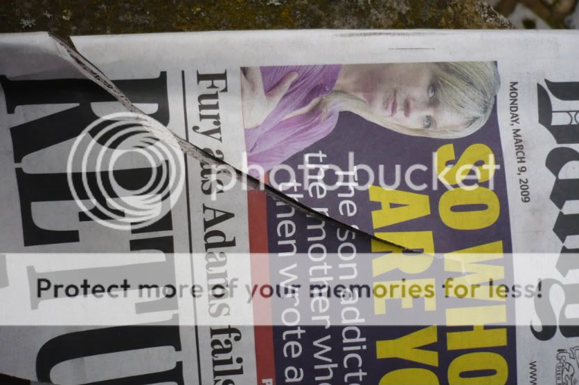

The NMFBM has been stripped and re-profiled to a convex edge of around 20 degrees either side...it had a quick run over it with a glass bead blaster but this has been removed in many places with use. I used this knife to take down a blackberry orchard frame and wire construction which had given it a fair old work out and I re-sharpened the edge and gave it a bit of a leather strop. The edge was certainly very sharp...able to cut through a thick newspaper ( 50 sheets ) on an easy draw...but not quite as sharp as the Khukri.
This was to be a chopping review though and I doubt it mattered...the NMFBM was plenty sharp for this.
