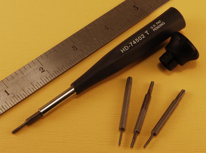

Lots of people blame cheap drivers, but I've been removing T-6 screws from Spyderco clips for 12 years with this $5 Husky set from Home Depot (2004 price, they've probably gone up a buck or three) without incident and I've pretty much reached the stage of life where putting the lid back on a peanut butter jar three times in a row without cross threading it is an accomplishment. My secret? If the screw won't turn using just the bit, without the handle, I apply heat and try again.

It is easy to use one size too small of torx bit.
The manufacturing tolerances of the smaller bits seems to be all over the place.
It is easy to round off the edges of the small torx bits.
Tape a piece is sandpaper to your workbench and scribble with your torx bit like a crayon, making sure to hold the torx driver completely vertical.. You can really sharpen them up and get better bite. This has worked very, very well for me.
