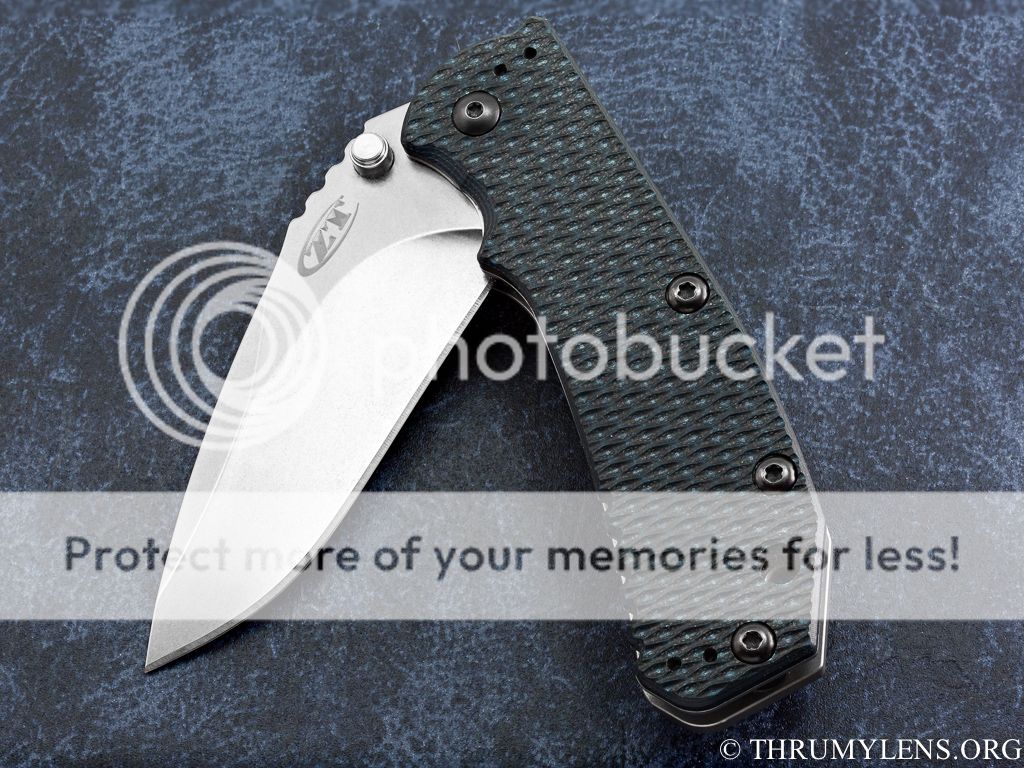

It was the first time I was photographing as many knives, more than a dozen in not terrible conditions..
I would be more careful the next time to "small details". Remains to be seen if I could fix all this...
I agree. My preference is for a little more backlighting so the shadow isn't so deep or harsh, too.The shadow beneath the knife could be improved I think. It's very dark for one thing. And it doesn't seem quite even: it has a sharp fine edge under the blade, but is faded and 'soft' around the handle.
Although the blade face is lighted very well, the final edge bevel appears totally black.

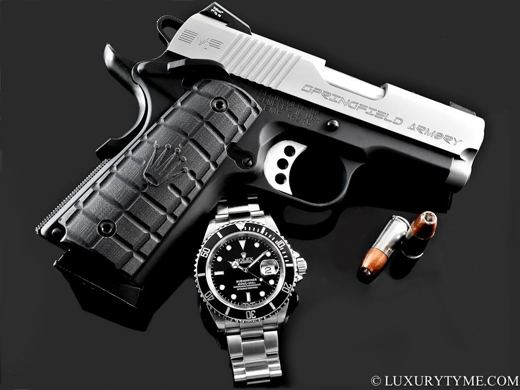

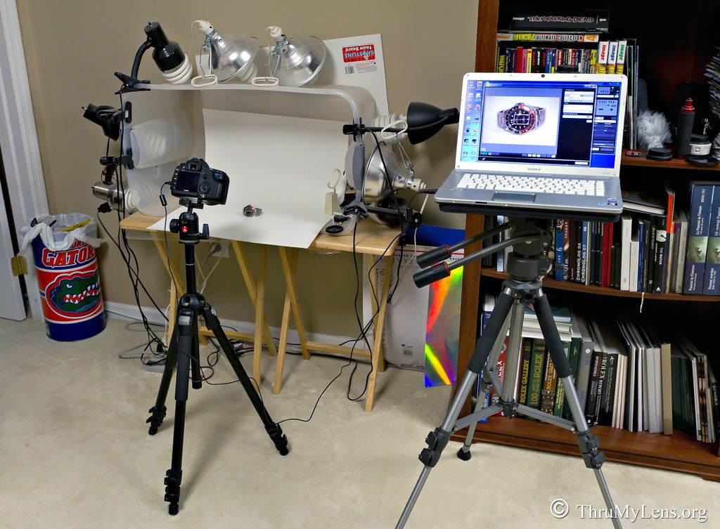

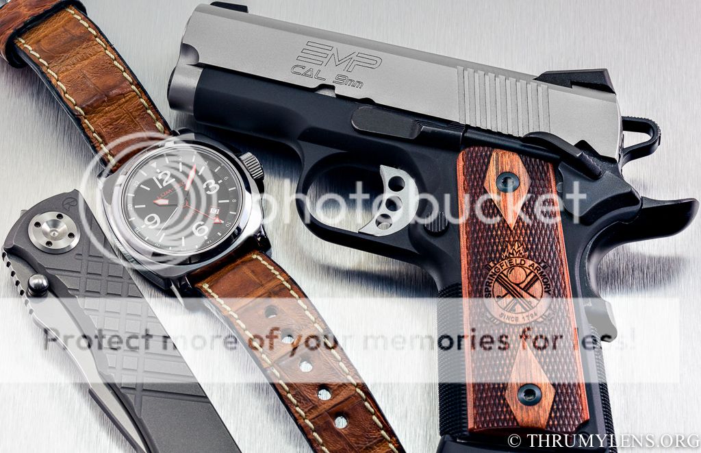

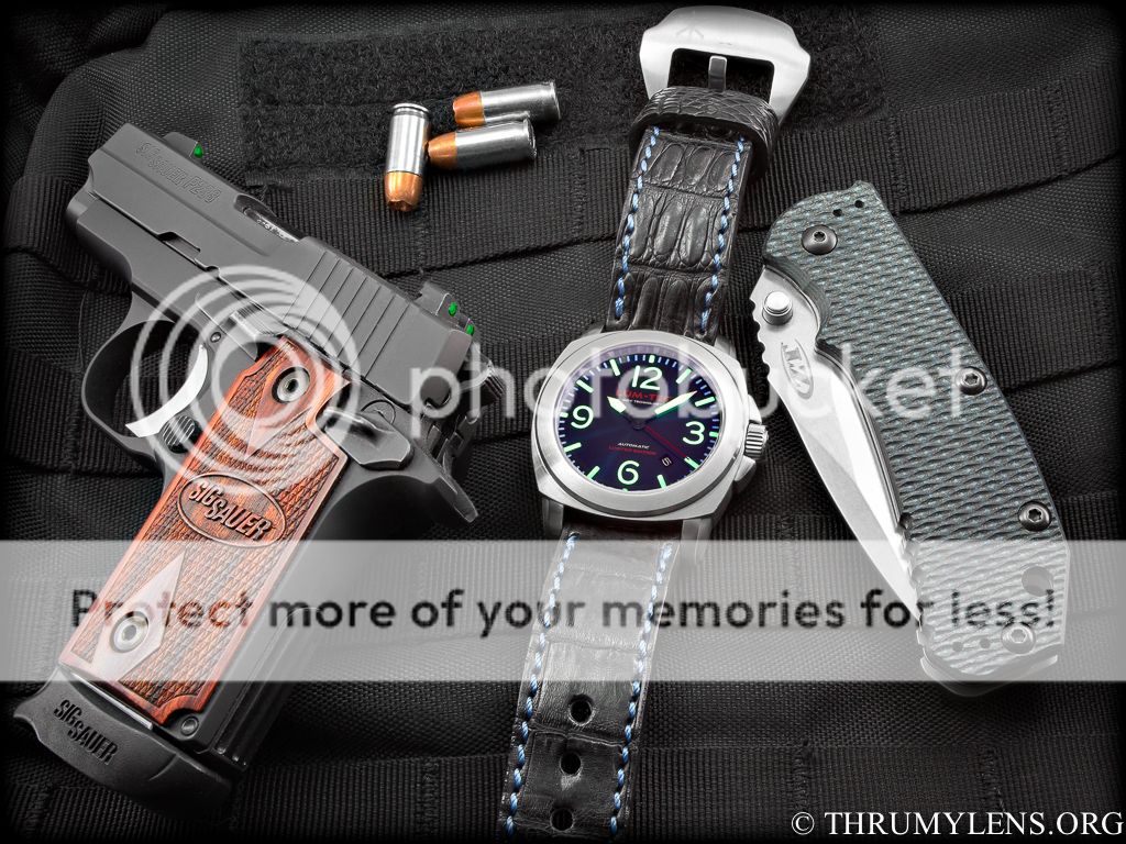

^^^ Now THAT is some clear photography.Love the homebuilt light 'box'. Surrounded with cheapo clamp bulbs.
I'm sufficiently impressed. (Jealous? Yeah.)

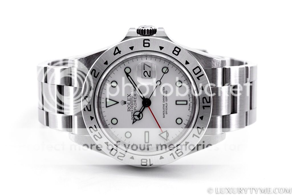

If I may, I've done a bit of watch photography, also. VERY difficult, indeed.

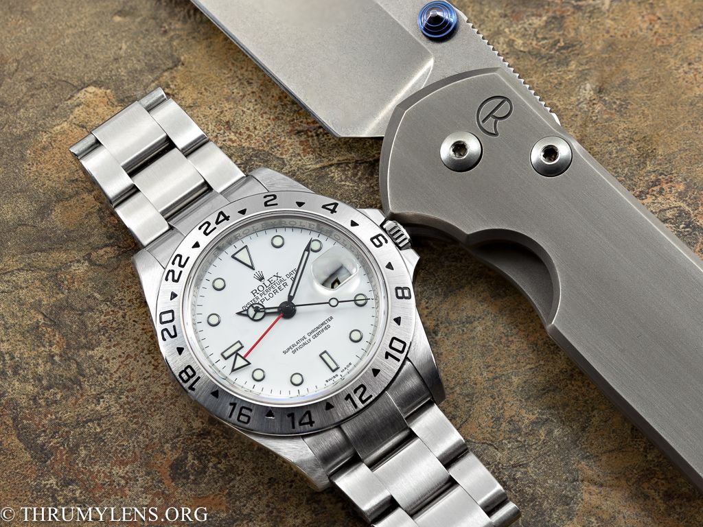

Rolex John: To your point, I am VERY 'left-brained' and don't have quite as much artistic creativity as I'd like. That said, I make no apologies for my perception of what appears correct to my 'left' brain. Maybe that's why I'm so popular. I appeal to the masses. LOL!
Balislinger: Your images are VERY clear and the work is showing well. More in a moment...

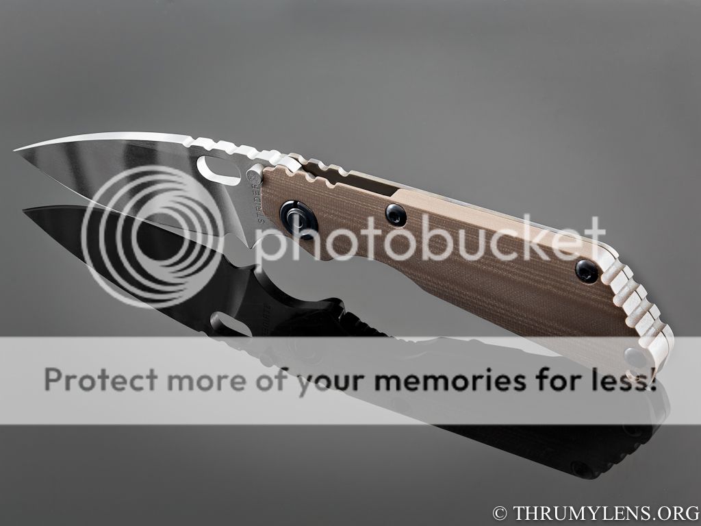

Balislinger (Steve?): This is a great example of why at least a pair of lights are needed for better knife photography. And you have them.
In the top example the handle needs about twice the lighting than the blade. (Exaggeration, but you understand). If you can't change the intensity, then change the distance. Draw the blade bulb away and bring in the handle light.
Sheaths, handles, and damascus suck up the light, and the brightly polished areas are always reflecting too much. It's a constant piece by piece adjustment.
Notice how the same lighting on the bottom folder gives near-perfect results. (Only 'near perfect' because you lost the highlight on the edge out at the business end, where it counts.) That needed a smaller mirror angled differently to run it around.

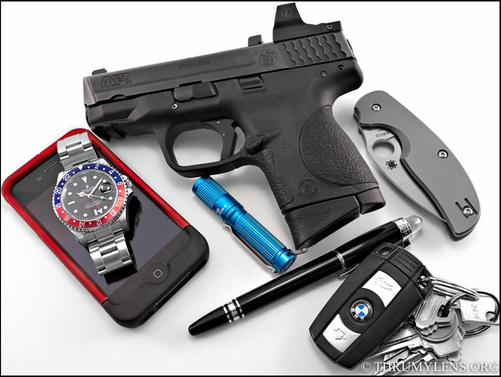

You guys amaze me! I might get flogged for asking buy do you guys ever take any outdoor shots? While I love and actually prefer clear crisp shots for sales, Id like to see what you guys can do outside! The creativity Im sure would be killer.
