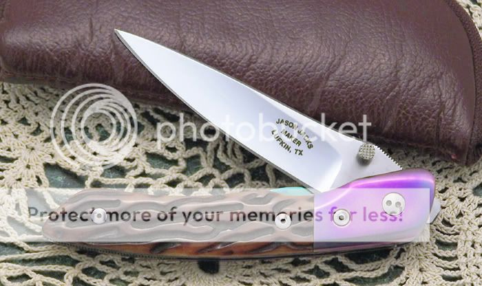

Hey guys, I've kinda skimmed through this thread trying to learn about taking photo's. My wife bought me a kodak Z740 5 meg pix digital camera the other day for my birthday. I like it so far but don't know anything about camera's yet. I built the light box Coop Show at the beginning of this thread, I made mine out of hard bord, I seem to have to over do most things I do, but anyway the lights I have are 75 watt but they don't specify day light bulbs. I'll have to change them. I've taken some pictures lately and some turn out ok but they still seem pretty fuzzy to me compared to most of yalls. I'll try to post them Some are of a slip joint I finished this morning, a liner lock I finished last week, and my light box setup. I love you photo's Coop, I frequent your website usually every few days to see if you've added anything new. I would use you for taking pictures of my knives but I'm toooooo tight! :D Thanks for all the help Coop & everyone else. Dwayne
http://i49.photobucket.com/albums/f253/ddushane/lightbox1.jpg
http://i49.photobucket.com/albums/f253/ddushane/lightbox3.jpg

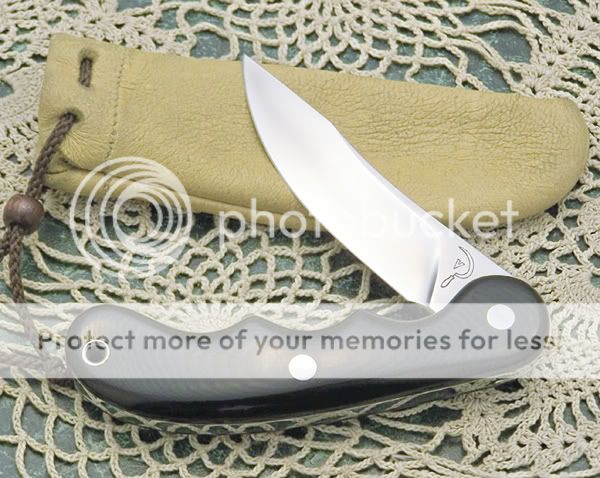

this is about the lightest background I use
standard
keep the eye on the knife not background.
here is something from the handles thread (well, actually it has not been posted yet as I have not done the stag stuff) but this is good to look at
standard
ok, now I'll post an image with the main background I use and keep in mind it is exactly the same background as what you see behind the cutout and the cutout is just part of the main background. all that has been done is some simple image manipulation to create a more interesting but related background.
standard
I have various parts of the background that I use at different times but you get the general idea. It is an old painters concept that dark makes light.
now from looking at those images, you will also note that the composition is such that not much background is left over (cropping) and that the knives are on the diagonal to create leading lines whereas strong vertical and horizontals are quite static in nature.
check the thread as I believe I posted the type of lighting that will work very nicely as Daylight Flourescent.
I'm not familiar with your camera so don't know its closest focusing distance and that is something you may want to check out. Also check out is you have macro capability which is great on the Nikon 995 CoolPix.
good luck with your photo endeavors.

You have good clear photos. A lot of light. I would suggest moving the lights back some, to create a little bit of shadowing towards the front. It is directly overhead right now. Then you will have a better visual of the shape and the depth. Come in from behind at a 45* angle and use a board reflector in the front.
As I learned, a light box gives images a bit of a hazy look, so adding more contrast will really help give it some 3-D again.
Keep at it, you smart cheapskate.... :p :thumbup: ;)
Coop
Thanks guys, I'll keep all of it in mind. The camera does have macro, but not sure what that is, I just know I read it somewhere in the book. It's also got a 10X zoom but haven't figured out exactly how to use it to my advantage.
Coop, as far as the lights, for some reason when I shot the photo's today that are posted above, I put the lights real close to the plastic bag. I'll back them off a bit and make sure to have them pointing in at a 45* angle like you said. I'll also try to use a darker back ground like Murray said. I appreciate the helpful hints, I also appreciate you starting this thread in the first place. I've always wanted to be able to take good pictures of my knives and will have someone else shoot'em when I'm at the show's but haven't gone to any in some time. One question, is it better to get the camera real close, or back it off and use the zoom? Thanks again for the comments, Dwayne

Dwayne,
Set your camera on macro, even if you shoot from 24" away. Don't use the digital enhanced zoom. Zoom to the point of non-digital enhancement (Many cameras have a guide for when this starts.) The '10x' feature is bogus. They just expand the data to a larger frame, without a true zooming in closer.
Get in 12-18" away on a folder.
The light's proximity is OK, and yu may want to step down your aperature (f-stop) or shorten your shutter speed to get less light in. Just drawing the lights down will have the same effect, though.

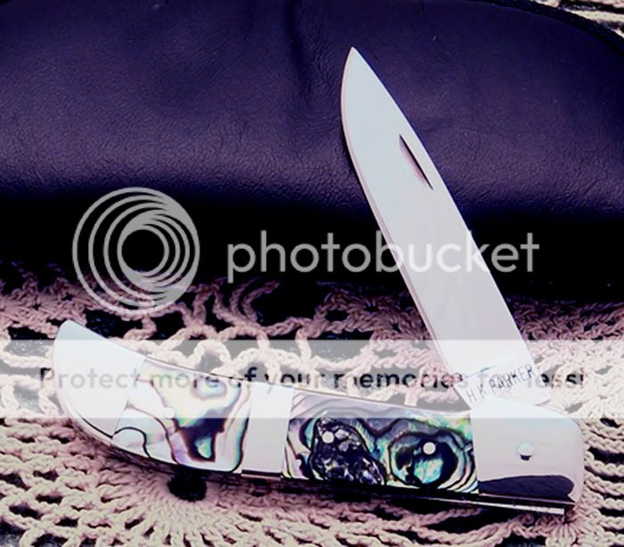

Hey guys, I'm using your tips, Here's some more pics. The one on the blue background was done with the lights backed off and the camera up close; approx 12" away. The one with the green background w/stars was shot without lights on the light box, just the lights on in the kitchen, I thought it was the best so far. Thanks for the help & comments, and any additional comments are welcome. Dwayne
Murray, How do get your pics to post so big? While on my coputer working on them in photo shop, if you view them in actual size they seem to be enourmous, I mean only being able to view the bolster, some of the handle & less than half of the blades. What's up with that? :confused: Dwayne
