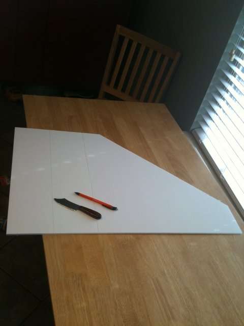

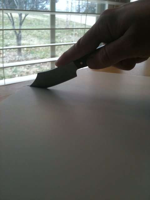

The first thing that I did was make the box part out of 3 sheets of foam board (aka poster board). I didn't have any measurements so I just laid it out using my phone as a length of measure so that both sides would be the same and I used the foam board as a straight edge.
Then I cut it out using a knife (one of my pocket cutlasses in this case).

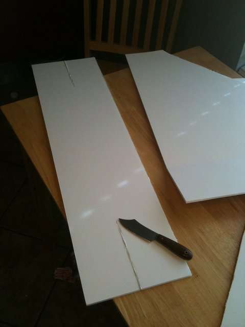

Here you can see how I cut the sides. Notice that it folds. To do that just cut through the top layer of paper and foam leaving the bottom layer of paper intact. Remember to make that cut on the opposite side of the board for the other side so that they fold in towards each other.

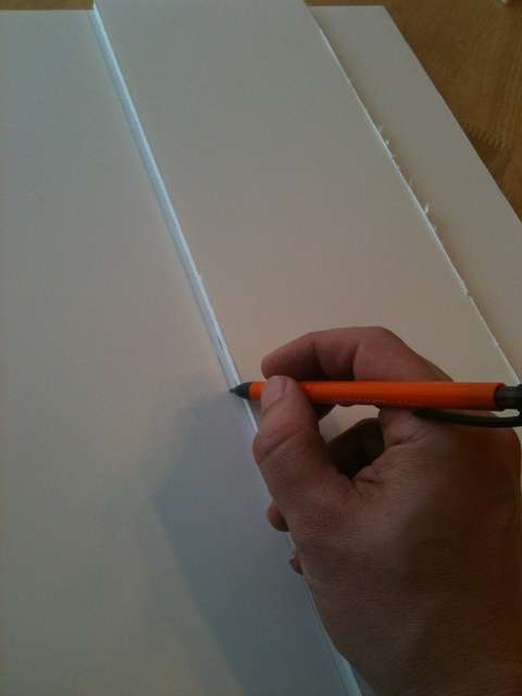

In this shot you can see the line where I am about to trim the part that folds in making about half as wide.

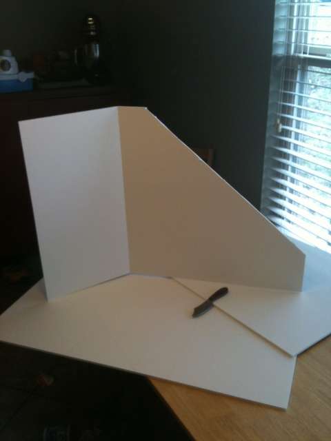

Here is the front piece after I cut it. The slits will go on either side of the flaps that were cut to fold. You will be able to see that in the next picture.
In this shot you can see how the slit and the flaps fit together. You can also see the other crossbar. For this one I just taped it on.

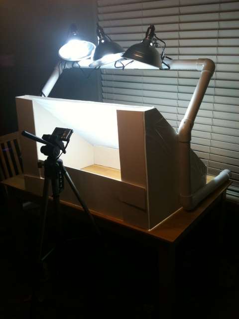

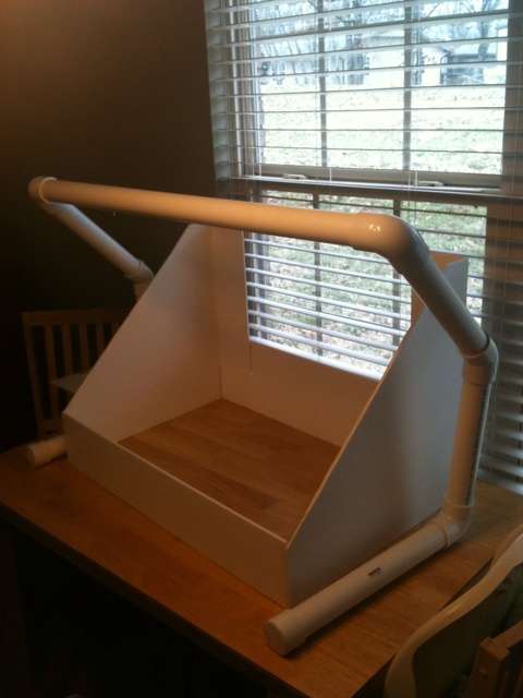

Now it is time to start working on the light bar:
You will need about 8-10 feet of pvc pipe and these fittings: (4) 90 degree fittings, (2) 45 degree fittings, and (2) end caps
Here is what I built with the pvc. This will hold the lights.
This is how it looks once it is finished. One thing that may be hard to see from this angle is the diffused material that now spans across the angled part of the lightbox. This diffuser material is a white trash bag. It is just taped on. The lights are 5,000K daylight compact florescent bulbs. With the clip on lights and the pvc bar you can move the lights closer or further away or angle them in different directions. Also, notice that my camera is just a little point and shoot.
And now a little disclaimer before the next picture... I haven't had time to play with it and when I shot this I was needing to take all of this down as I had constructed it on the kitchen table. :eek: So I am not really doing this set up justice.

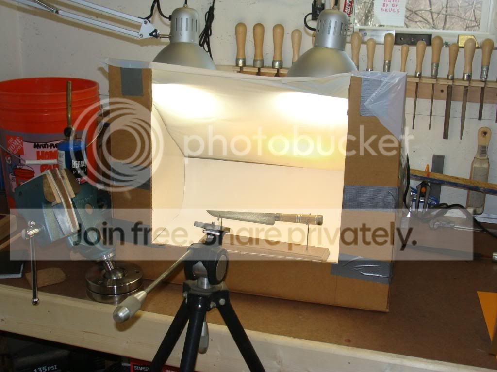

I am using the same bulbs as you. Got them at the depot. This is my setup, just cut up a large cardboard box, and lined it with poster board.
Thanks guys ...
You gave me the incentive to build something. Built one today for about $5. I built it into a box I had that will close up for storage. I think it works OK?
