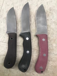

https://hosting.photobucket.com/ima...89456D7B.jpeg?width=320&height=320&fit=bounds. 3 of my current knives. I don’t build these to be overly pretty, granted I’ve made some nice blades before. These are for heavy use. Mostly hunting guides and outfitters. Two in ztuff, and one in 3v. I have a like for a slight recurve to the grind, I feel it makes it easier while breaking down game, or even wood carving. The recurve seems to bite into whatever I’m cutting a little better than a straight edge. These are relatively thin on the edge. The red one is my current ztuff, hardened to 62rc. Around 15 thousands at the edge. It’s more of a test blade for me. It’s the low temper, pre quenched blade I recently made, flat convex ground. It has a terotuf handle, 1/4 inch corbys and epoxied with gflex. I’m basically beating the hell out of it to see what it can handle. Just figured I’d post some pics of some of my crappy work. Lol
Thank you. Most of the people I’ve sold to don’t take care of their knives. So I have chosen function over anything. Reliability goes a long ways in the woods!

Hi, hard to tell from the photos, but do you bevel the leading edge of the handle to where it meets the blade, or have the end of the handle 90deg to the steel to keep the cutting edge as absolutely close to the hand as possible? Carving wood I like a close cutting edge, been told hunters use that bit of blade less than wood workers. Anyway, I have found that angling the front of the handle 20 or 30deg off perpendicular to the steel makes it lots easier to clean any blood, fat, dirt or moisture from the handle/blade join.
