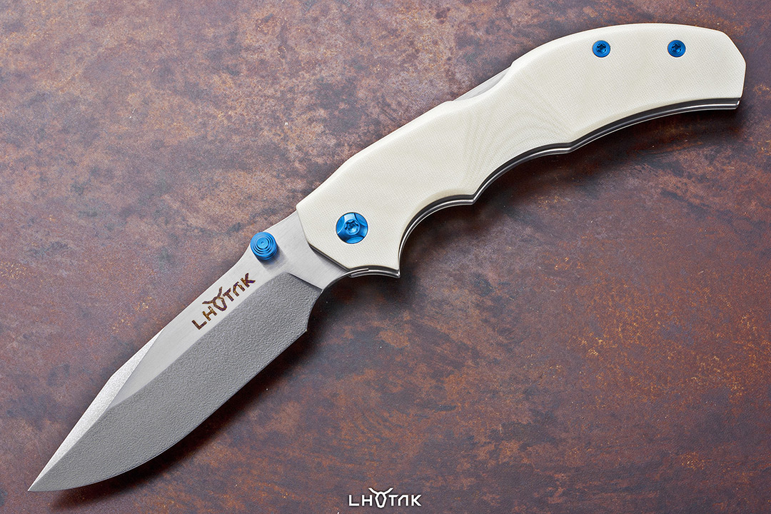

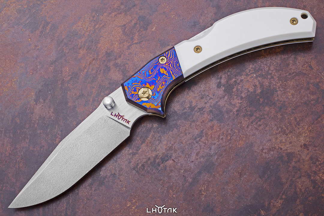

Hello,
After some 20 years of knife designing only, i started to make knives a little over 2 years ago. So just a little longer then you.
My "shop" for the first year was a tiny old table on the balcony and the kitchen table, a small cheap vise, a drill press and a bunch of files and tons of sandpaper.
That said, this is what i made, with files and sandpaper only. You mentioned it took ages, tell me! I made everything from heat treated Titanium!
My very first knife:
My 4th knife, first time with handle scales:
My 5th knife, first folding knife, a Lockback, all parts made by myself (except screws):
My 22nd knife, still everything made with just files and sandpaper only on a balcony and kitchen table:
What i try to say and show here is, don't use the "i have files only" as an excuse for lazy or unclean work. As mentioned here, try your best to make it as perfect as you can no matter how long it takes. You will also learn a lot this way. Making a clean knife can be learned, but you have to want it. Sure, you may need a little bit of skill too but IMO the most important thing is patience and passion. When it comes to selling, i have big problems selling something i can't stand behind 200%, so any blemishes, scratches, imperfections, gaps are a no-go. It also should not be your first priority, just saying how i think about it.
