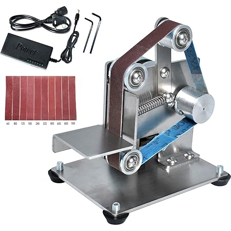

Was going to suggest you need more than one belt, but you mentioned you don't have a belt grinder
This one is on Amazon for $140. Chinese made, but could be a good practice tool. 1.2" belt size
I don't make knives, so take my reply for what it's worth
