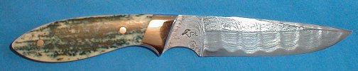

I have a set of five of his Muteki kitchen knives I purchased years ago while he was still living and working in Japan.
But my claim to fame with Murray is that I convinced him to make his first neck knife. (I have, I believe, the second one he made after he convinced himself that it was a great concept...and one fancy one that he brought to the Blade Show when he was going for his master smith rating.)
