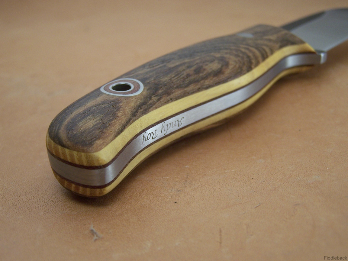

Folks, due to the unbelievable sorry-itude/shitbagituity of vulcanized fibre (standard knife liner material), I have decided to upgrade to micarta and g-10 liners only. The expense of these is between 2x more and 8x more. It is worth it because these materials are tough and stable.
A while back I started a thread to complain/comiserate with other makers about this problem. The consensus was that this material (again, standard in the business) is shit.
http://www.bladeforums.com/forums/showthread.php?t=707280
The switch has actually already happened. This will mean you see a lot more Fiddleback knives with no liner at all. Also, from now on, choosing a liner on an order will incur an upcharge, and an upcharge will be charged on knives posted for sale with this superior material.
Let me give you an example of what I'm dealing with here. Vulcanized fiber is available to me for ~$2 a square foot for any color. Now I'm paying $4 for a sq ft of black paper micarta, $6 for an 11.5 x 8.5 piece of red g-10, and up to $16 for a 12x12 piece of white g-10. White is rare and expensive because its so easy to contaminate whole batches with dirty equipment and make it look like trash.
The good news is the look.
White g-10/nat canvas micarta/white g-10
Nat canvas micarta:
Black Paper Micarta:
Nat Canvas Micarta:

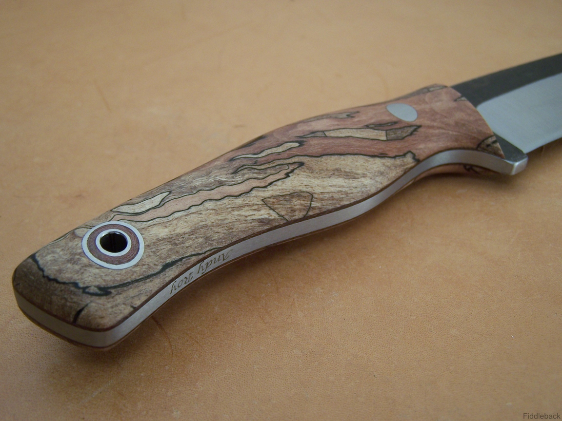

I like the new liners...but the spalted maple done stole the show!
What spalted Maple? All I see is 0.031" of nat canvas micarta.
