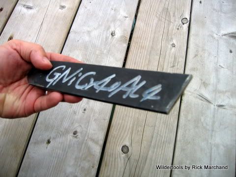

Everyone wants the new hot mix. It seems the more letters and numbers in the steel type the more impressive.... try some of this exotic new kjgh-hg68 unobtanium alloy!
I think this also depends on other factors, though such as the style of your knives and the market you're after.
It isn't all bad. I do enjoy trying new materials.
I do have a bar of some of the brightest of the bright and lightest of the light... as soon as I figure out how to make it rust and wear, I'll use it for something.
