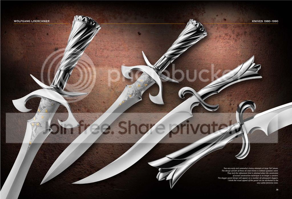

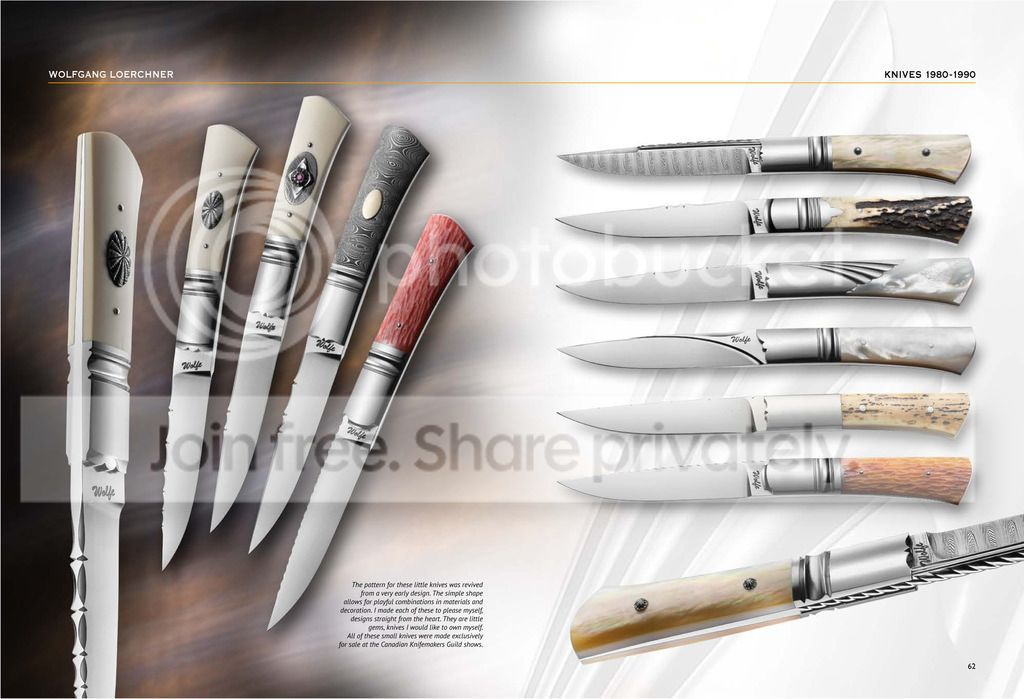

The knives below were made in my $30 workshop. I purchased some files, a flea market hand held drill and a hacksaw. For holding parts I found an old and very cheap vise. Using a minimum of equipment will teach you much.

Well, there ya go. All ya need to make world class knives. Wolfe, you are The Man!

I'm going to go out on a limb and say you are probably the exception, and not the rule! I about pass out looking at your work!

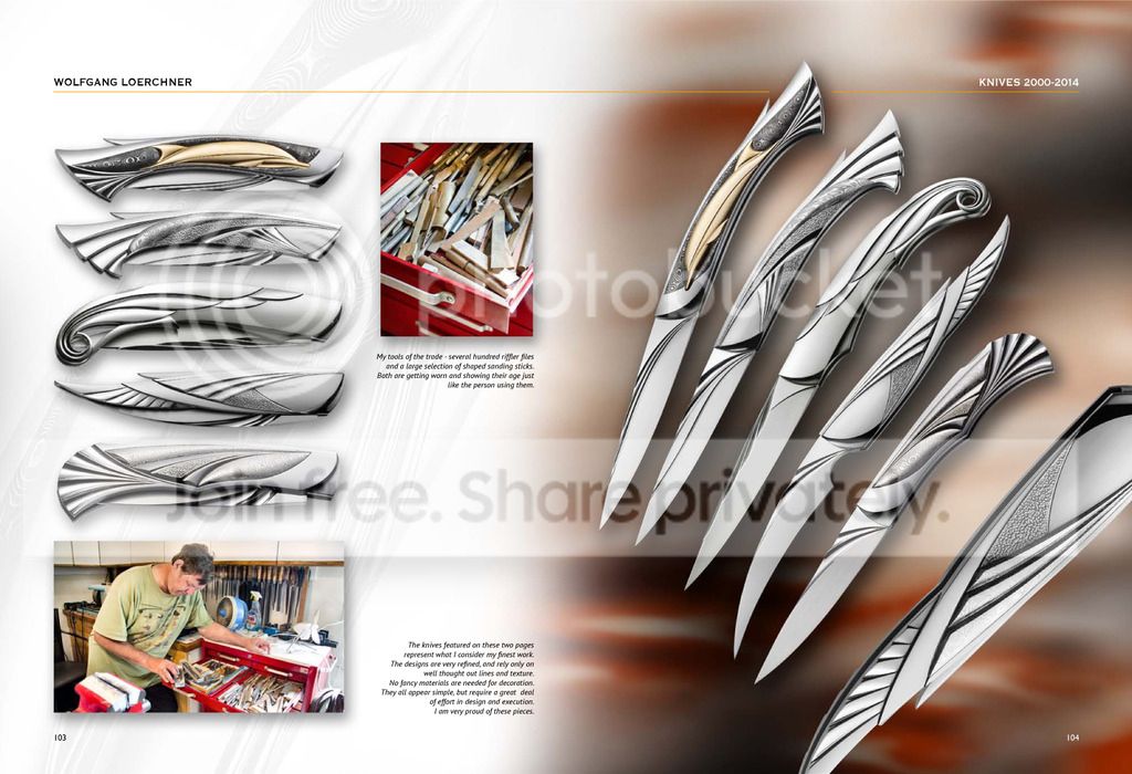

Yes, maybe an exception. But that is only because few new makers actually give this method a real chance. It is not for those who wish to make this an efficient or money making proposition. If you actually want to get payed for your time, you are really starting a small busyness. Starting any small busyness will take some start up funding. If you only make some knives for pleasure, it is a great way to start. The experience you gain from using hand tools will always be an asset. Though I have since added a bandsaw and a couple of drill presses to my shop, I still use the same methods. A very large assortment of files does make life much easier of course.

MUCH respect to you sir!
How do you finish grinding in your bevels post heat treat? Diamond files? Diamond stones?

I hand finish all my blades to 600 grit before heat treating. Finishing the blades only requires minor sanding to remove the film left by the heat treating process.

So how thick do you leave your edge before heat treat?

I have never measured the thickness at the edge. I simply get it to the point where I can sharpen with a very small secondary bevel. I now make folding knives almost exclusively. The blades are small, and some carry extensive filework. If I had to reduce the grind by any amount post heat treating, the geometry of the file work would be compromised. Never had a problem with warping during heat treat.
Note, all work on the frame is done by hand, no grinder involved at any stage.
