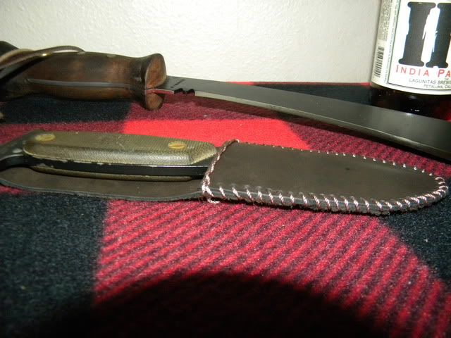

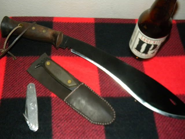

Cranked out Episode 1 of my EDC sheath last night, I need to find a pocket clip somewhere cheap but other than that it's done. I thought the HEST's kydex was low profile, well... this thing isn't even comparable.
PS sorry for the crappy photo quality, the L100 has the worst possible screen and I can't tell what the heck is going on while operating that thing... and for the huge images-I resized them in Photobucket but they refuse to load that way once I post em.

I went for low profile EDC pocket carry, it's pretty ideal so far. Like I said I need a pocket clip to put the icing on the cake-that way it can be used as a boot knife, belt knife or pocket EDC. Basically tried to encompass all of the shortcomings of the kydex. No more rattle when I walk :D Since there seems to be such an interest in HEST/Izula/RC3 EDC carry lately... tonight I'm making a jet black copy of this one for the RC3 RAT Pack edition with the orange G10 handles. As far as the HEST use, I guess high desert is about as close as you can come to hell :D That and spending 9 months in my pocket... I have one of the first run serial numbered HESTs that apparently had chipping issues with the powder coat as well. It's been battoned heavily and has seen some pretty brutal tip work... still a Godly slicer though. This thing really is the do it all blade. I'd ALMOST consider it to be the 'one knife', which is why I'd love to see a 4.5-5 inch DPx blade.

It's in my pocket dude! I could easily add a strap but I form fitted the leather... this thing is tight. It's not handle heavy either. I'll keep a close eye on it with EDC use this week and if it's necessary I'll add a strap.

Two things glare out at me right off.
There appears to be no welt. Welting protects the stitches from getting cut and releasing the knife very near some treasured items.
Also, the leather appears to be really thin and flexible, again, that blade is really close to stuff you probably want to keep in good working order. I'd suggest a stiffer/thicker backing to ensure the tip of the knife isn't going to wander around in your pocket looking for something to poke.
Sit down too fast or fall, and things are going to get interesting very quickly.
Take the aforementioned advice as you see fit, it comes from a few years of experience. I've also heard the stories and seen the scars from substandard equipment.

Thanks for all the input gents, and I'll definitely take the time to make a welt on round 2. So far the stitching is holding up well. I dyed it with RIT and waxed it with Carnuba. I chose thin leather on purpose so it would conform to my pocket or a boot and be low profile. I probably could have gone an ounce heavier but so far it's done well. I understand Jeff, how living down south and working in the jungle would be a pain with trying to maintain leather. The most humid it's been in the last 2 months here was 12%, so fortunately I don't have to worry about it. The sheath got a hefty mink oil coat this morning so as long as I maintain it I'm hoping it holds up. Just picked up a UPS box with an opinel, another sodbuster and two Trams, made the most out of Smokey Mountain's free shipping last weekend. I previously couldn't justify buying some of that stuff because the shipping was more expensive than the product, but the trams are getting leather wrapped handles and baldric sheaths for dayhike bushbeating. The HI Khuk has served me so well! As nice as a genuine HI khukri would be, this is no doubt a superb working man's tool. The balance feels like a tomahawk and it bites real deep, again with Condor's super slicing edge. The handle is also probably my favorite machete grip thus far.
