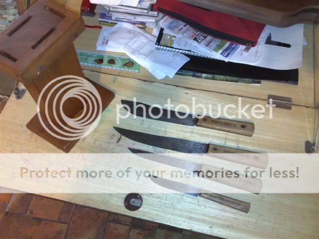

why the huge mora craze, yet i hardly ever read mention of old hickory knives? :eek: the local do-it-best hardware store had some old hickorys in stock, so i bought one of the little paring knives and what they call a slicing knive (i fell in love with this in the kitchen this morning cooking some lamb for work)
the paring knife though, is a very handy sized blade, it had a very reasonable edge from the factory, and i whittled a good few sticks with it during my lunch break with no apparent edge loss... i know its not the most attractive knife out there, but the steel seems good (read that its 1095 online) and it feels solid.
any particular reason for them having such a little following on the forums?
