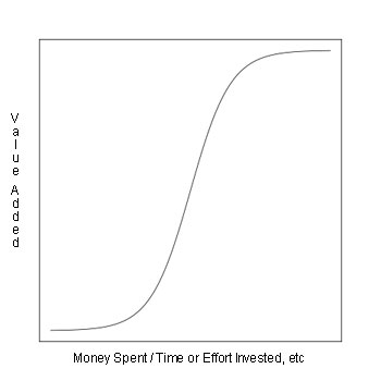

I was surprised to see that there was no sticky created for the basics of knife sharpening in this forum. If it exists elsewhere and I'm missing it somehow I would appreciate if someone could direct me to it.
That's not to say I didn't stumble upon some in-depth threads in this forum on all the various finer points of obtaining and maintaining the perfect edge, that's all fantastic information and excellent discussion by obvious enthusiasts of the craft. But I feel its also way over the top for beginner-to-medium knowledge of many. Sometimes having too much information is a bad thing, it paralyzes us and prevents us from acting and this is why I think a sticky on the basics would be an excellent addition here. Here is a general phenomena I have observed on forums of all types, be it for home audio, cars, knives, whatever, basically anything people are passionate about:
As you can see, there is invariably a 'sweet spot' in the middle where you get the most bang for your buck (not just money-wise but also your time invested, etc). If you go too low on the graph you get an inferior product, or in the case of the actual sharpening you do it shoddily and you wind up with a poor edge because you didn't invest the time and technique to do it properly. Conversely at the top end you get expensive products and complicated techniques and equipment (much higher learning curve too), and yes, while they do improve on the overall final outcome it eventually becomes a product of diminishing returns.

I'm just gonna say it: this is a really weird first post.

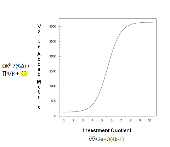

While I see your point, using a graph with no data points? Cmon.
exactly what data points would you like to see? The x-axis is ambiguous because it signifies 'investment' (be it in time, effort, money, etc), if you know of a single unit that represents all those then I'm all ears. If you think its a stupid question or that I've explained it poorly then I apologize
Haha no I get your question, I just think using a meaningless graph is a weird way to illustrate a point. Though I guess I'm probably overthinking it. Just a pet peeve, really :P
I understand the graph perfectly, though in the case of sharpening the effort in/value added would be the steep part, the money in/value added would be a much more gradual curve.
yeah its not a perfect analogy I agree because sometimes the x-axis is money and sometimes its skill or technique or materials, but if you use it sort of loosely in that regard you can apply it to virutally any specialized forum, just like this, try it, you'll be amazed ;)
this should be more understandable to you since I've included gridlines and descriptions and such
