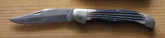

I've got this one with no stamp. I can see a part of an etch of a crown under the nail nick.

Josh a nice example of a #44 folding hunter pattern..they not all had a blade etch and were either a Q Stainless or Q Steel tang stamp
