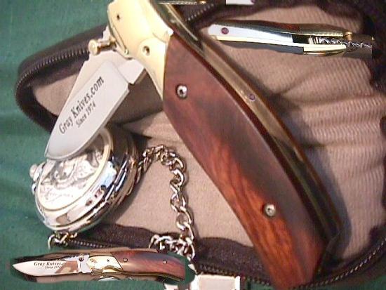

FWIW - here's a set of 416 bolsters where I used the same, hidden pin process:
