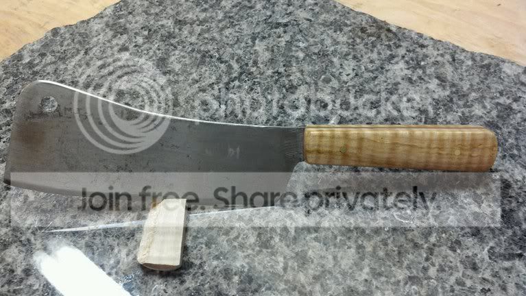

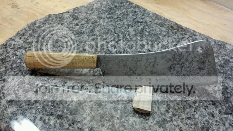

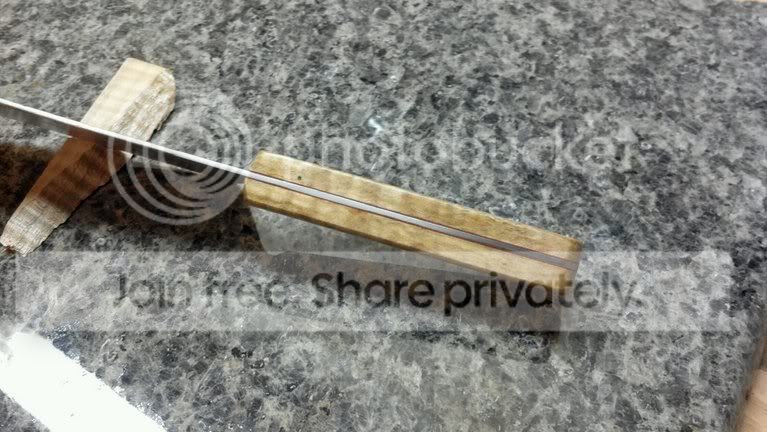

I finally got a leather project out of the way so I could work on this one. It turned out pretty well for my second attempt at making wood scales. I ended up just pinning the scales on, as the guy I am doing this for didn't want to spend money on ordering some Corby bolts and a step drill bit for me. I used devcon 2 ton epoxy to glue the scales on and the pins in and made an epoxy pin of sorts between the two brass pins to try to give it some grip other than just surface to surface. A couple of pin holes, and a couple of bigger holes showed up as I was shaping the scales after they were glued up, so I used some epoxy to fill them in. I sanded the scales up through 600 and finished with a few coats of tung oil.
Here's pics, let me know what you think.
Nice handle, and great figure on that maple.
If you round the corners you'll see the striping a bit on the spine too.
I have a couple knives with unstablized maple on them, and the wood has shrunk slightly. It is finished with Tru-Oil. I don't know how far it will go, but am keeping an eye on it. The tang of the knives are now a bit proud of the wood.
I have 4 such knives, two each from two different blocks of wood (incl. the one currently in my avatar). The piece that came here (New England) this summer from humid Virginia seems to have contracted a bit more than the block that's been in the basement for a couple years, which I cut from a firewood log. Going back and sanding the tang edges down carefully would probably make them look really close to mated again.
